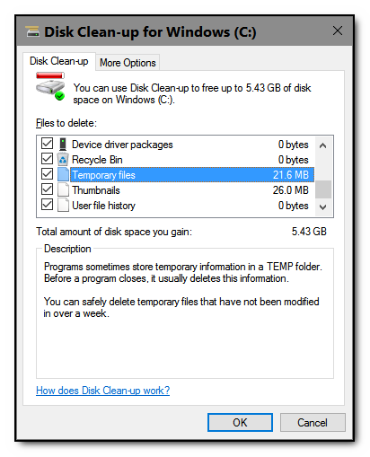

It is thus generally a good housekeeping practice to periodically run cleanmgr.exe (in Admininstrator mode and set to to clean up system files). When doing this, ensure that there is a tick against the "Thumbnails" item. For example:
The example screenshot above shows 26.0MB of Thumbnails - which is not much really and is usually larger (I had already not long ago run cleanmgr.exe before taking this screenshot).
