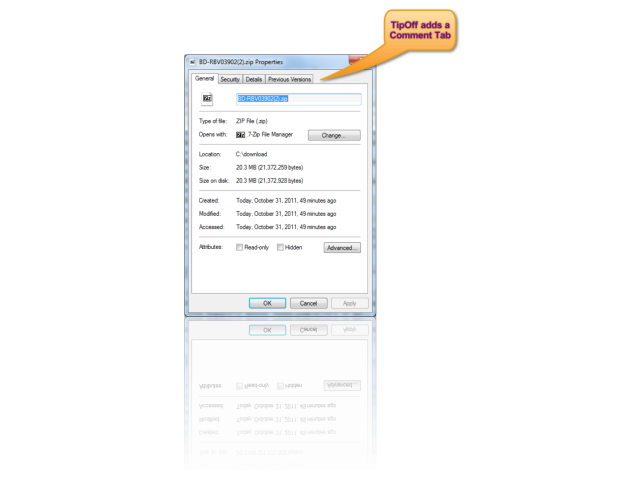

If 32 bit, you can install TipOff
http://www.favessoft.com/tipoff.html
I no longer have it accessible in the menus on my page because I have moved to a hotkey based download comment program. But if you like a small edit box where you can type in comments, this supports about 4000 characters or so... at least for ANSI.
The screen shot you see on the web page shows the ToolTip behavior that gave the program its name.  But in the Comment Tab of the Properties Page you get a standard Edit Box control.
You right click a file, click Properties, and you'll see a Comment Tab.
It's an Explorer shell extension.  For that reason it does not work in 64 bit Windows.

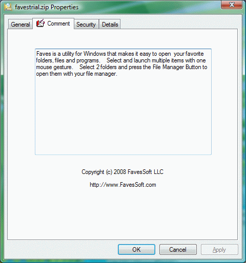

Here's a screen shot of the Edit Box in the Comment Tab. It's an old screen shot.  I started doing these Comment shell extensions about 10 years ago.  I have no longer any desire to redo them as 64 bit.  They worked, but Windows doesn't really serve up the comment in snappy fashion. It's just kind of a clunky way to get to it. Even with the ToolTip there was a lag between mouse hover and the tool tip display.
