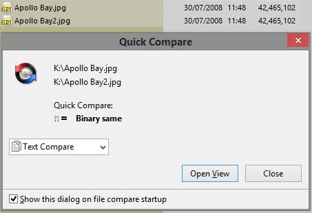

XNView, from my testing just now doesn't change the file size appreciably when doing a Lossless JPEG rotation unless your options for JPEG writing will cause information, (metadata, internal thumbnail, etc), to be stripped, added, or changed.
eg. Here's the results of a 40MB JPEG after it's gone through four Lossless 90° Right rotations when compared to the original:
Maximum difference in file size was ~60kB and that was only after the first and third rotation, (ie. the image was now 90° left or right rotated w.r.t. the original).
