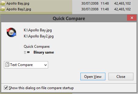

And you still don't mention whether you're using Lossless JPEG Rotation, arbitrary angle rotation, etc.
XNView, from my testing just now doesn't change the file size appreciably when doing a Lossless JPEG rotation unless your options for JPEG writing will cause information, (metadata, internal thumbnail, etc), to be stripped, added, or changed.
eg. Here's the results of a 40MB JPEG after it's gone through four Lossless 90° Right rotations when compared to the original:
Maximum difference in file size was ~60kB and that was only after the first and third rotation, (ie. the image was now 90° left or right rotated w.r.t. the original).
dcsev

Since you haven't attached an image that's giving you problems, this is the one I'm using to test, so the following are just screengrabs of the results of each step:
1) Original (42,465,102 bytes, 10358x3803 pixels 300DPI)
2015-04-22 10_38_03.jpgRIOT tool that respects folder hierarchy? (for JPEG compression?)
2) Step 1 - compression with PhotoResizeP100ICROEG (6,587,712 bytes, 10358x3803 pixels 300DPI)
2015-04-22 10_38_18.jpgRIOT tool that respects folder hierarchy? (for JPEG compression?)
3) Step 2 - Rotation using XNView 2.32, Lossless 90° Right (6,570,854 bytes, 3803x10358 pixels 300DPI)
2015-04-22 10_45_09.jpgRIOT tool that respects folder hierarchy? (for JPEG compression?)
As you can see, the picture is rotated and the file size decreased after rotation.
