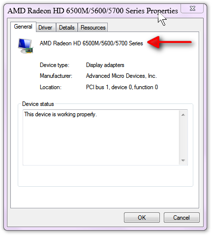

I have an HP Envy 14. The specs say it has:

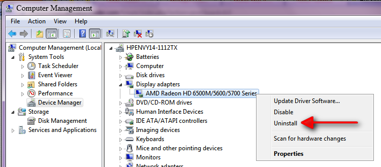

Having run out of ideas, I wondered whether maybe the existing installed driver might be blocking the upgrade installation.
So, rather nervously, I removed/uninstalled the driver via the Computer Management Console:
That left me with an 'orrible-looking display.
I reran the upgrade installer, it got a bit further along this time, but still hung, so I killed the process.
So, I got Windows to scan for new hardware, and it reinstalled the (previous) display driver.
This returned me to the state at the end of STEP #2.

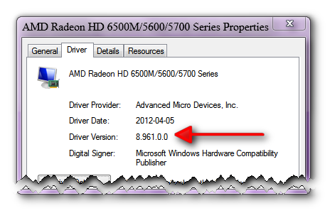

So, with ATI Tray Tools installed, I used the .msi driver installer buried in AMD's latest (v12.4) driver/CCC installer package (I was tempted to try AMD's latest ß release version from NotebookReview.com, but decided on caution), and installed the very latest stable driver.
So I was left with the latest driver installed (v8.961.0.0) and the display adjustment capability that I needed. Success!     :Thmbsup:
