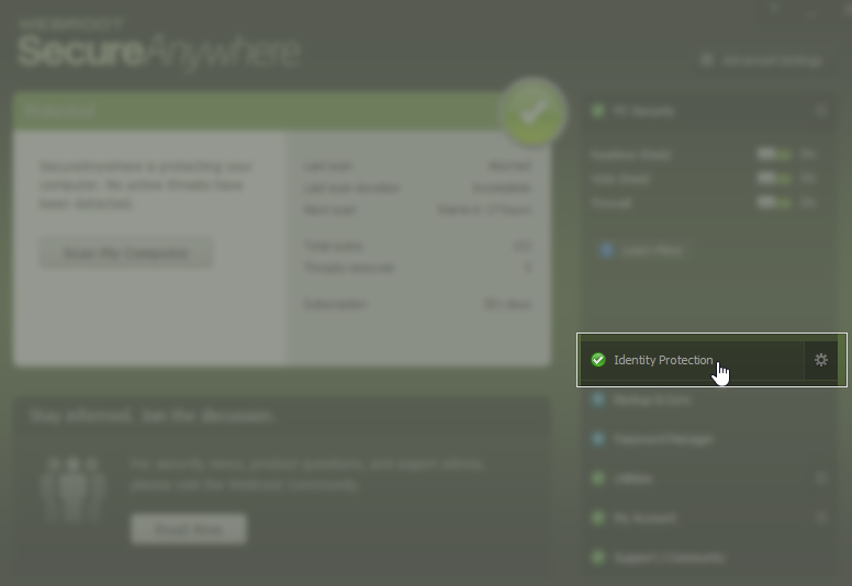

The second method preserves the full protection of the Identity Shield function, but isolates Screenshot Captor and allows it to operate correctly. To use this method, first, click the settings icon (Gear) next to the Identity Protection label.

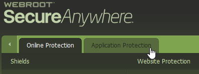

Click on the Application Protection tab.

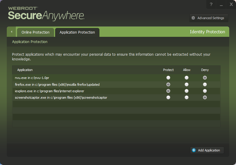

In the Application Protection dialog box, Screenshot Captor should now be visible and the protection setting should be Deny.
I'm not smart enough to know the difference between the Protect and Allow options, but I do know that selecting either one of them will enable Screenshot Captor to grab screen data.

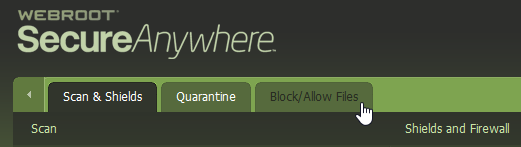

Then click the Block/Allow Files tab.

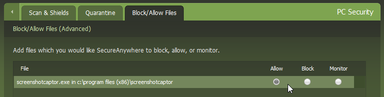

Here, Screenshot Captor should be seen, although I don't recall if Webroot put it here or I added it. So, if it's not here, be happy.
Notice that this dialog box uses the same three protection states as the Control Active Processes. They are in fact, ganged together. If the protection setting is changed here, it will also be changed in Control Active Processes and vice versa.
One last observation regarding the three protection options - If an application is set to Block on the Control Active Processes dialog box, that application is removed form that display. It won't be seen there, so it can't be un-blocked from that dialog box. To un-block a previously blocked application, the Block/Allow Files dialog box must be used.
