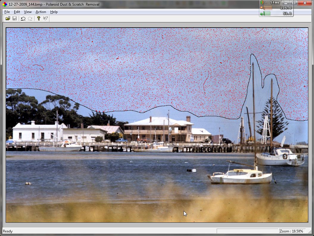

Yes - it's a really old thread but hey, I started it  :D
Anyway, I finally finished doing all my slides, (yes, I am slow), and I thought I might share an example of what PolaDSR can do:
Before:
12-27-2009_144-before.jpgBatch photo filter software?
During:
2012-11-02_10-53-59.jpgBatch photo filter software?
After:
12-27-2009_144-after.jpgBatch photo filter software?
The before and after photo are scaled 50%, the filter would have removed the rigging from the yachts so they were masked out.
PolaDSR is attached as it's a little hard to find now - it's free and hasn't been in development since 2002.
