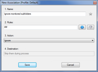

Just also found a tool named DropIt.
Got it working, partly only: when configured to monitor a folder, it copies the files in there alright.
However, regretfully I could not find a setting that it will only monitor that folder and nót process any subfolders in there.
If you want to ignore subfolders of monitored folders, you can select “Always process folders and not scan them” from Options (“Main” tab) and add the following association as the only one for folders
fetch.pngHow to automatically move specific files from c:\users\username\documents
Source: Dropit Website

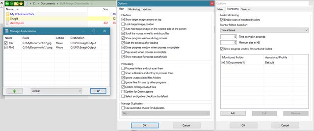

As for DropIt I tried following, without success.
