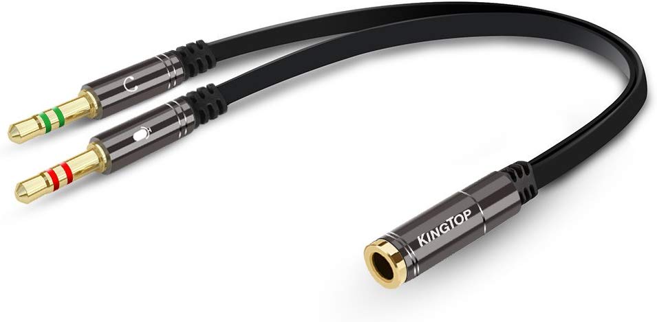

I saw a listing for a Y-cable that was labelled as being for two microphones and specifically showing that it was not intended (or possible?) to be used for a microphone and headphones. That makes me think that the way the internals are wired makes a difference.
I found this one, which has the prongs in the configuration that I'd prefer. But the fact that the prongs are labeled as one being for headphones and the other being for microphone makes me wary. I don't know enough about the inner wiring to be sure it will do what I want.
https://www.amazon.com/dp/B01I3A47KM/
I want to plug one end into my computer, another end into something else, such as a tablet, and then merge both those audio sources into a single place I can plug my headphones into.
Will this one work the way I want it to? Or do I need to buy a regular splitter and then some adapters to convert the male and female ends to each other? Or is it a bad idea to even attempt anything like this?
The DIY stuff didn't really make sense to me. I'm not an electrician. I don't know much about electronics. I don't want to fry anything by wiring something up the wrong way. I'd really prefer something simple and easy like a Y-cable if possible, and avoid the extra bulk and complexity of a mixer and all the adapters that would require. But I'd also much rather spend an extra $20-30 on a proper solution than cheap out with the Y-cable and fry some of my $300-1,000+ hardware.
I found this Reddit thread which has every answer, from "it works, no damage" to "it works, but will probably sound terrible" and including "it might work, but will probably sound terrible and could do damage"
https://old.reddit.c..._be_used_in_reverse/

This will do what you want as I was describing, as long as you are ok with each source being in a different ear:
https://www.amazon.c...-Cable/dp/B000068O5H
As different reviewers states:
"With the great help of splitting the two mics in the two different audio side (left and right) you are able to record two mics and have their sound separated"
So you would plug your two different audio SOURCES into the two female jacks, and they will be merged into a stereo signal where one source is your left ear, and another is in your right ear.
There is a caveat though, it is only going to pass through one channel of each input.  So for music, this could be a problem, where the left+right channels might have different content, and one of those channels will be ignored.
I believe in that case your solution would be to add an adapter that would first convert the stereo input source to a combined mono source, e.g.:
https://www.amazon.c...apter/dp/B0002EOHX0/

Yeah, that first one wouldn't.  You're trying to combine Stereo into mono, so just reversing the cables won't work. That second one is what I've used in the past.
Are you saying that the one I linked wouldn't work, but the one mouser linked will work?
And I guess if doing it mouser's way would result in audio from one source playing in one ear and audio from another source playing in the other ear, then I could just get another one of those stereo->mono converters to have both audio sources playing (in mono) in both ears.

I'd still need to buy a bunch of adapters and/or other cables to reverse the direction of the prongs. The splitter has 2 female ends where I need male, and 1 male where I need female.

Deo, I've been doing DIY electronics for a while now.  A Y-cable may work, but is risky, for reasons I probably don't have space to explain adequately, but basically it's possible to accidentally fry the output of one output by combining it with another output, without isolating each from the other.  Ask me how I know  :(
The next best solution would be to find or build a Y-cable that has resistors on the junctions to act as a static passive mixer, but even better would be a simple stereo mixer.  These are the best I could find on Amazon for as cheap as possible.  You may be able to search around and find them cheaper on the eBay or other site.  They have input jacks for stereo 3.5mm plugs, two adjustable inputs and one "straight through" main input so you can mix together 3 different devices.  USB output also  8).  Listed in order of price from ~$33.00 to ~$50.00:
