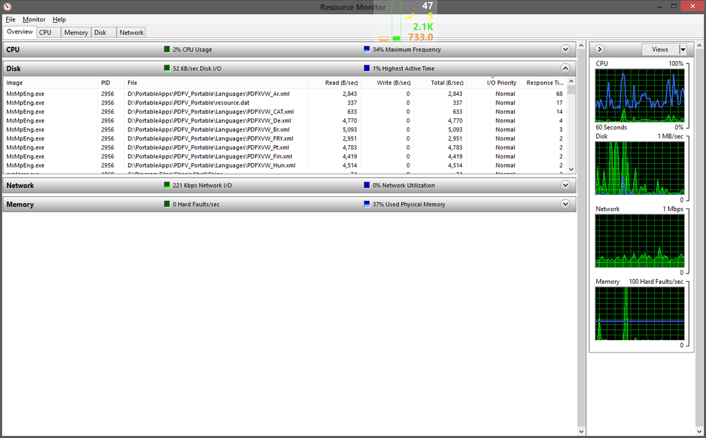

Given that I'm not a supergeek, something easy to use and easy to interpret, please.
Windows Resource Monitor - open a CLI or at the Start menu type resmon.exe, and then look at the Disk tab.
2014-01-19 14_44_35.pngWhat's thrashing my hard disk?
You'll get the process, how much reading/writing it's doing, the priority, and the drive response time, (which can be a very good indication of whether there are bad sectors - high response = possible read/write error possibly also indicative of a drive fault as 40hz mentioned).

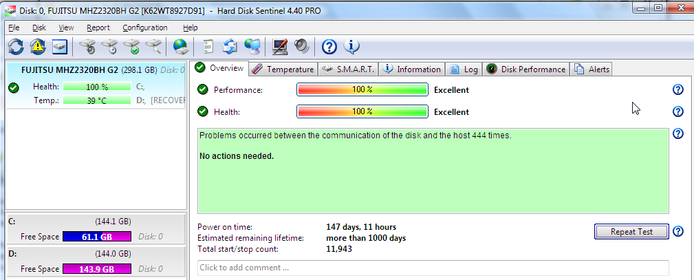

It's a laptop, and I'm a klutz  :(  But I ran Hard Disk Sentinel a few weeks ago, just before doing the last disk image.  As far as I understood it, which isn't very, it gave a clean bill of health.  I just ran it again, with this result:
HDSentinel_report1.pngWhat's thrashing my hard disk?
(Given that it's a Samsung laptop, I was surprised to see a Fujitsu hard disk)

Doesn't "Power On: 147 Days" tell that you haven't allowed Windows to update for about 5 months? Maybe you simply need to close Windows, (and start it again), for the updates to install, so your Windows Update can rest?
That does not mean that.

Just as a matter of interest, Fujitsu transferred their HDD assets to Toshiba back in 2009 - your HDD is over 5 years old, (2008 model).  Even though SMART says it's fine, if it's your main computer or you use it heavily, I'd probably look at replacing the HDD now or in the near future.
Depends on your mindset of course - I generally wait til they go toes up  :)
I'm still surprised to find it inside a Samsung, though.  I'd have expected them to use their own HDs.
I'll probably do the same :-\  But as it's a laptop, I suppose I'd have to replace the whole thing.  It's (probably) not quite as serious as it sounds, yet; I don't think I even used the machine much until a year or so after I'd bought it (maybe that's the effect Vista has on you) and it's my personal machine, not one at work that had an intensive life.  HD Sentinel gave it the all-clear, too.  But, I suppose I'd better start keeping an eye on laptop reviews  8)
