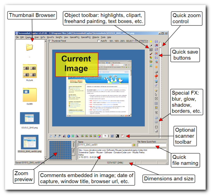

My Screenshot Captor (link here) does have a little bit of a learning curve, but I do believe that after you spend just a little time with it and configure it to match your workflow, most users would find that it is trivially easy to do everything you need it to do, and in the most efficient manner.
Having said that, each to his own!

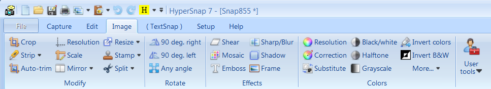

I've used a program called HyperSnap for many years. It snips, crops, resizes, alters colors, captures, does scrolls and regional scrolls, etc. etc. I'm not a sophisticated user, but I've found that I don't need to be to use it for my varied needs. I've tried other programs, including the more expensive SnagIt, but found I much preferred HyperSnap. I also tried mouser's Screenshot Capture, but although SC is a fine program, I didn't see any reason to switch and have to deal with a new learning curve.
HyperSnap isn't free. I don't remember what I paid for it umpteen years ago, but it currently sells for $39.95. It's now in version 8. I'm one version behind, because that version already does everything I want. (I may upgrade just to support the helpful developer.)
Here's a screenshot of one section of the program:
HyperSnap.pngsnipping tool with image editor

For those who happen to stumble upon this thread and don't know, DonationCoder's own Screenshot/snipping/annotation tool is Screenshot Captor (I am the author):
https://www.donation...ps/screenshot-captor
