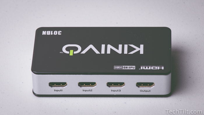

The pigtail switch did not work
I then got this powered switch, which does work:
"Kinivo 301BN Premium 3 port High speed HDMI switch with IR wireless remote and AC Power adapter"
Kinivo-310BN-HDMI-Switch.jpgHDMI signal drops and reconnects (Mac) - DC plz help!!1
It didn't work right away, the signal didn't pass through the old HDMI cable. I had to upgrade my HDMI cable to:
"BlueRigger High Speed HDMI Cable with Ethernet - CL3 Rated for In-wall Installation - Supports 3D and Audio Return",
It's not necessary to manually switch to a null output (the device doesn't even allow it) or to power off the device when I'm using the TV for something other than mirroring the computer, the switch took care of the handshake problem and works flawlessly, no drop in video quality either.
Thanks again to everyone who chimed in.
Edit: It just occurred to me that I hadn't tried using just the upgraded cable, without the switch. It f***** works! There's no need for the switch at all, upgrading the cable was all that was required. lol
