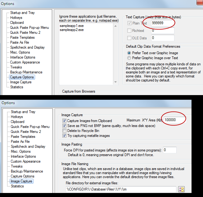

« Reply #8 on: October 22, 2013, 03:00 AM »
@tomos
maybe increased some buffersizes here and there ?
