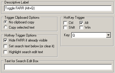

2. Configure a way of toggling FARR that doesn't involve setting or clearing the previous search text:
[attachthumb=#1][/attachthumb]

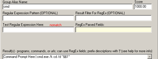

3. Create an alias 'cmd' for opening cmd.exe with a search result (as described in: https://www.donation....msg120331#msg120331):
[attachthumb=#2][/attachthumb]

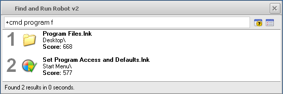

4. Bring up FARR using the toggling method defined in 2. and type:
+cmd program f
[attachthumb=#3][/attachthumb]
