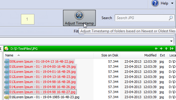

7. Enter title: Adjust Timestamp (A),
click on Drop down menu (B)
select "Run an Opus function (not supported in Explorer), (C)
click on "OK" (D)
B/C are incorrect (both are B there - C is actually missing). It should read:
click on Drop down menu & select "Run an Opus function (not supported in Explorer), (B)
click on Commands and select Adjust Timestamp (C)
click on "OK" (D)

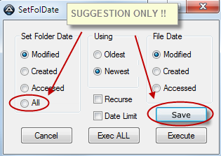

Then I have two suggestions:

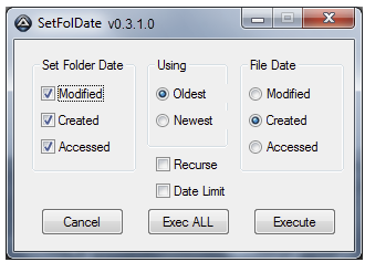

1) when updating folder date, would it not be possible to:
a) update two or all dates at the same time?
e.g. modified/created, or 'all'
(at least often modified/created go 'hand-in-hand', i.e. they are both about the same date)
2) have a kind of default setting added
This to come up when clicking on the button and no(!) folders are selected.
Right now, when clicking on the button and NO folders are selected... nothing happens - rightfully so.
Maybe in thát case
a) the button-window to pup up - with greyed out [Exec All] [Exec]-buttons
b) users can then 'set' things (e.g. select 'All' and 'Newest')  and click on 'save' so those are then 'defaulted'
c) in future when redating there the pop-up window will not appear anymore, i.e. folder is redated as per settings.
BUT.. again, maybe this is too complicated, in which case, drop the idea... okay?
« Last Edit: September 13, 2013, 01:36 PM by dcwul62 »
Maybe in thát case

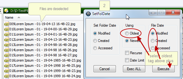

Rather than add All, I'll just change the radio buttons to checkboxes and let you select whatever combination you want.
I wondered how long it would take for someone to ask for a Save button  ;D
I'll see what I can do.
Haven't forgotten this, just busy with other things.
Explorer version works, rather than have a save button it just saves/reloads the last configuration used.

When it's finished, I've got the Explorer version done, still got to do the file manager version, (for DOpus, etc) - just have to stop playing Borderlands 2 long enough to do it  ;)
2nd Q: would it be possible to update
Created/Modified/Last Accessed date of a file, in 1 step, based on the oldest date of the three.
Err...the program updates Folder dates based on the oldest/newest file date within that folder - so I'm not sure what you're after here.

EDIT: SetFolDate 0.3.1.0 is up there.
« Last Edit: October 11, 2013, 04:10 AM by 4wd »

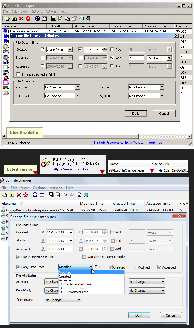

Frankly, I have not looked at BulkFileChanger because one element was missing/is missing on the printscreen of Nirsoft.
However, it is available in the real version: copy from ... options - being a major improvement.
It -sofar- has not an option to copy from 'oldest' date-time.
Also I am not sure how to 'incorporate' this in Opus, i.e. I would select one or more files, then hit a F-button, or a toolbar button, then the bulkchanger to be launched -with- the selected file(s), preferrably even with the action window opened, like in the above example.

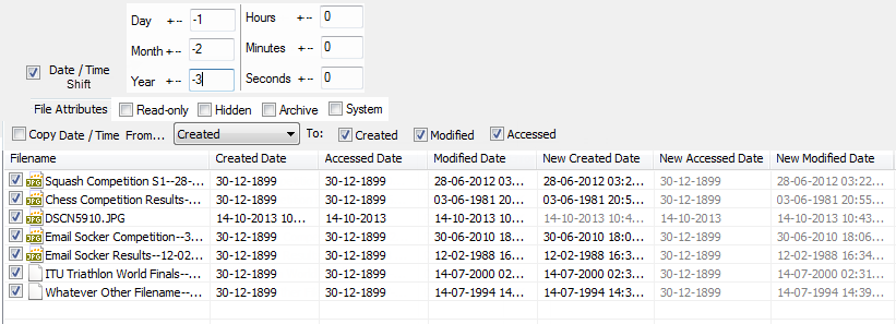

Basically it would be everything in the BulkFileChanger stuff,
plús:
Item [Dates]
New, tag/untag option: [X] Apply to all files and folders in subfolders
Item [File Attributes]
same as above

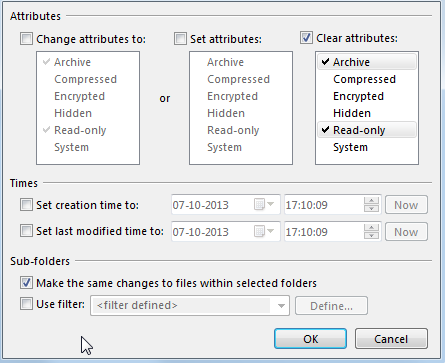

Opus has this feature for attributes, but has no  "Copy from ... "
I have not found any free attribute changers that can do this.

There are two executables in the archive, one for Windows Explorer, (SetFolDate.exe), and one for file managers, (SetFolDateFM.exe) - they are not interchangeable.
To install the Explorer version, copy SetFolDate.exe it where you want it to reside and run it.  Click Install and it will be added to the context menu for folders - Done!
For Directory Opus - maybe include attached PDF

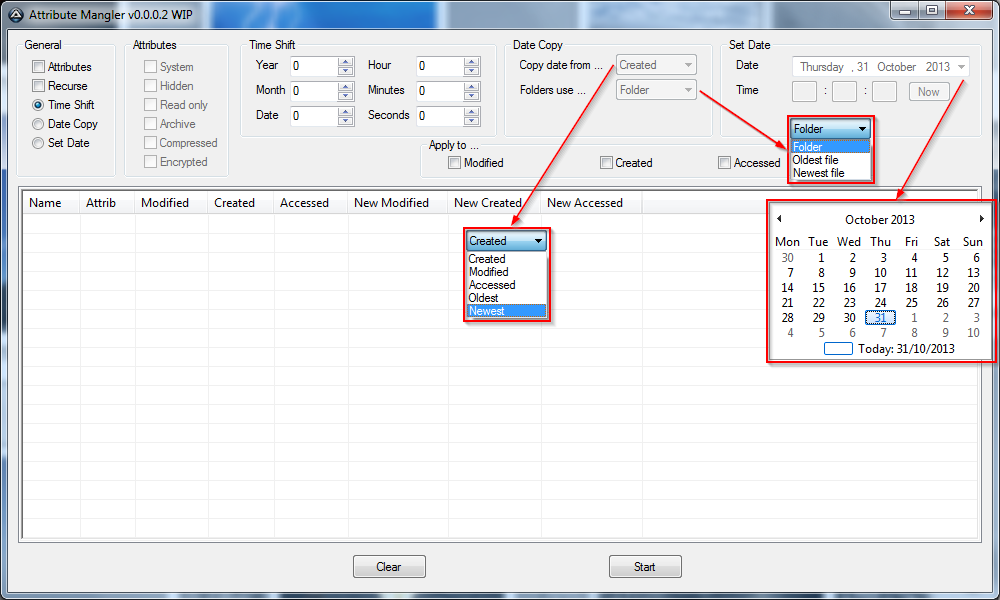

Are you still considering this?
I have tried out many attribute changers, but fact is, none them is complete.
The tool would combine a number of features:
the existing FolderDate tool
[new] file attribute changes
something like:
It doesn't look nice - I simply put a few things together.
Still thinking about it - I had thoughts about the interface but have been a bit busy around the property, (bushfire season coming up :) ).

Just playing around with the GUI atm:

Hi 4wd - up front - I am really sorry to get back to you only now.
This is because, one way or the other, I did not get a notification of your last post.
So I still had in mind your:  "Still thinking about it" (oct.21) and all the bushfires out there - so I assumed the idea gradually kind of moved downwards on your 'prioritylist' so to say.
Today, I thought I would check your ideas on this and noticed that you started out developing GUI already!
Did you think of a name? Something like the "Ultimate Attribute Changer"  (UAC)  :) :)
There are a lot of attribute changers out there, but product X is missing things product Y is offering, v.v.
Examples
a. a GUI that shows current dates (created/modified/last accessed) and preview of changes before applying
b. an easy way to synchronize dates after created, or modified, or last accessed
c. a randomize dates option: so, you can updated modified dates with randomized dates and times using  a certain period
d. add your update folderdates of course
e. add date-time (userdefined format) to filenames (not really a 'attribute changer'-thing, but maybe it can be added)
f. update modified dates after dates  or  dates/times  in filename  (a difficult one, I know, am not sure if it is possible, there are a lot of combinations)

Kind of on the back burner, no real developments since playing with a GUI other than you can drag'n'drop files/folders onto it.
I'm nothing if not an accomplished procrastinator ... just ask my wife  ;)
I went with Attribute Mangler, as soon as you write Ultimate anything someone wants to surpass it.  Besides, if I get something wrong it will mangle.
Examples
Maybe also add
- option to simulate?
and/or
- log changes, so users can easily 'undo' changes
You keep adding things to the list, I have to keep modifying the GUI ;D
* Donot know if it is possible at all *
You mean in SetFolDate?
Easy enough to add - although technically for recursion you'd have to start at the deepest level and work forward so the dates propagate correctly.  I'll have a look at it.
