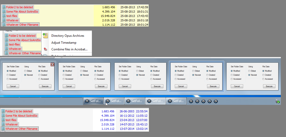

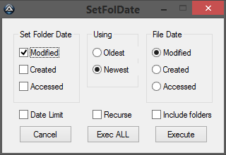

Interface is self-explanatory:
Left side is the date you want to set for the folder, right side is the date to use from either the oldest or newest file in that folder.  You can choose to recurse through the folder in which case the sub-folder date will be set from the appropriate file within that sub-folder.
Date Limit tells it to ignore files that have a date earlier than 01-Jan-1980 which Explorer can't display but other file managers can.

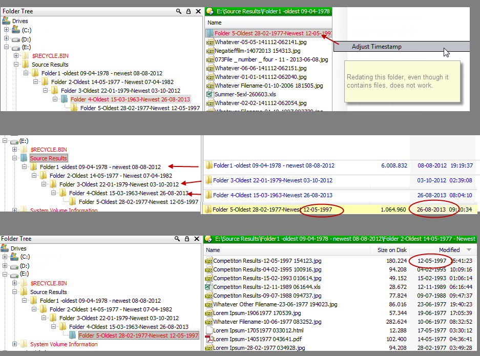

1) I think it is defaulted to 'Newest' - so when 'Oldest' is selected for one specific folder, the redating of the next folder will be again based on 'Newest', which is perfect (and normal)
2) As far as I can see, it can handle single folders, in Explorer's right window panel.
This means:
- it will not work on 'nested' folders
- and also when selecting a folder in the left window panel (tree).

3) for testing purposes I created a folder1, with 4 subfolders, i.e. upto subfolder5
One way or the other on subfolder5 it does not work.
I know, so many subfolders, it will hardly happen, I created it for testing purposes only.
Tried with another folder under subfolder5  (i.e. subfolder6) but that does not do it either.
I cud redate to 'oldest' date for folders1,2,3,4 and back to newest, no problem.

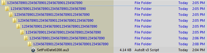

I think you've come up against the "path too long" problem, should be able to get around it hopefully - I'll see what I can come up with.
dcwul62
  • Joined in 2013
  • Posts: 336
Yep!
You are so right!
280 characters or something.
Didn't think of it...  :-[

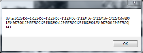

OK, this is interesting, it looks like Windows takes care of long paths by itself, (Win 7 x64), eg.
Here's a path I made that has in excess of 280 characters:
Here's the argument passed to SetFolDate:
Windows has used 8.3 naming (xxxxxx~1) to pass the argument, the number at the end (|143) says it's only 143 characters long.
This leads me to suspect the problem lies in the command I use to set the date.  I'll be able to get around that easily enough by changing directory before issuing the command.
Back to the drawing board  :)

ATM, I'm just working on getting it to work with multiple selected folders, (which will be if it's called from DOpus only - or possibly other filemanagers, depends if they can pass the same args).
I am thinking of a recurse option, maybe I'll start from scratch.
EDIT: I just realised that I can get the selected items from Windows Explorer - I did it in another script - back to the drawing board.

In the works, now got Explorer multi-select working, (which was easier than I thought), so it only runs a single instance now, (no multiple open windows).
Still to do:
1) Get it to work out whether it's run from Explorer or something else, (mostly worked out)
2) Recurse
3) Execute All
