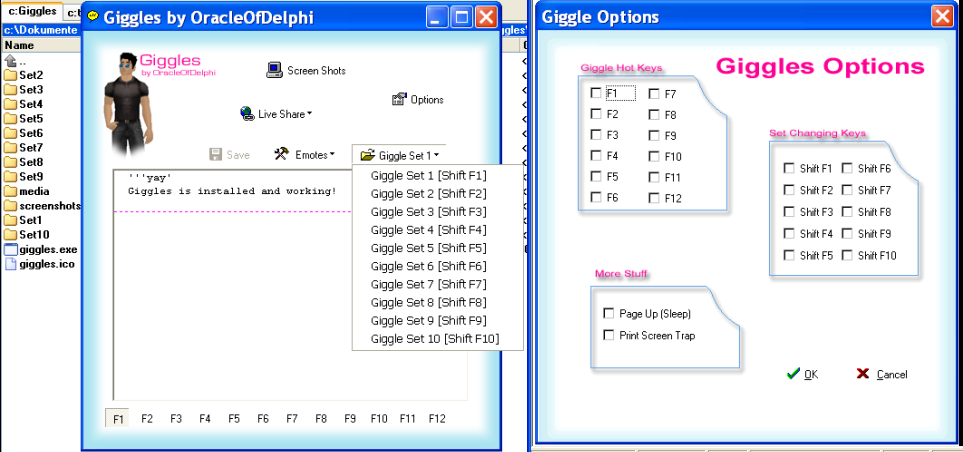

Ok, assuming you have read the title, here is the skinny:
I am trying to make a program to replace an old, no longer supported program known as Giggles (the site is down, it appears, so I cannot link). It takes user input and holds it, until a Function key is pressed, where it then takes the input and types it out.
I can get the program I have made to STORE the data (as the AHK script window hides, as it should, as I don't have NoHide set), but I can't get it to SEND the text. Can anyone tell me what I am doing wrong??? I have been working on it for a while now and if I don't get it soon I am going to go crazy...

Here is an download for your original Giggles:
Giggles Beta 9 - OracleOfDelphi's excellent software designed specifically for There.
http://www.thumdar.com/downloads.html
Giggles.pngAHK Help anyone?

Gui, Add, Text, , -------------------------------------------------------------------------
Gui, Add, Button, gInstructions, Instructions
Gui, Tab, 2
Gui, Add, Text, , WreckedGiggles is a replacement for the popular Giggles program developed for There.`nIt is coded by Brandon Seal, owner of CompuTech Computer Maintenance and Coding Co.`nThis program is known as DonationWare; it is free, but donations are requested if you like the program.
Gui, Tab, 3
Gui, Add, Edit, r5 w250 vf2,%f2%
Gui, Add, Button, gApplyButton, Apply

AbteriX
  • Posts: 1,149
Re: Request for AHK help...I feel so dumb...
« Reply #11 on: July 24, 2007, 10:27 AM »
Onces started it is easy to continue
so i playing around a while with this code :D
Spoiler

> Gui, Submit,nohide
I think the GUI should hide?????????????????
Just go to all field and fill in your text
and press 'Apply' at the last field only ?!

wreckedcarzz
  • Posts: 1,626
« Reply #15 on: July 24, 2007, 11:13 AM »
Ok, while I am skimming through I see a couple things that I think will work, and to answer the repeated question...
v is for variable, so vf2 is for Variable of Function (Key) 2
I have learned from experience to TEST before doing the WHOLE thing...as it can be a pain in the behind if all your things are wrong because you entered the wrong word, or put that comma in one bad spot, or that ! was really a keystroke... :-[ ;D
I am going to go ahead and try basically every idea here, and will reply soon if one works, and will add credit as needed in the top area of the script (at the little ; )
Thanks for the help/ideas!!!!!

wreckedcarzz
  • Posts: 1,626
« Reply #19 on: July 24, 2007, 12:07 PM »
I went ahead and tested it out. It works perfectly! :) I am downloading the SmartGUI now, and am going to give that a try.
That is the trick,   :greenclp: of course :read: :wallbash:
