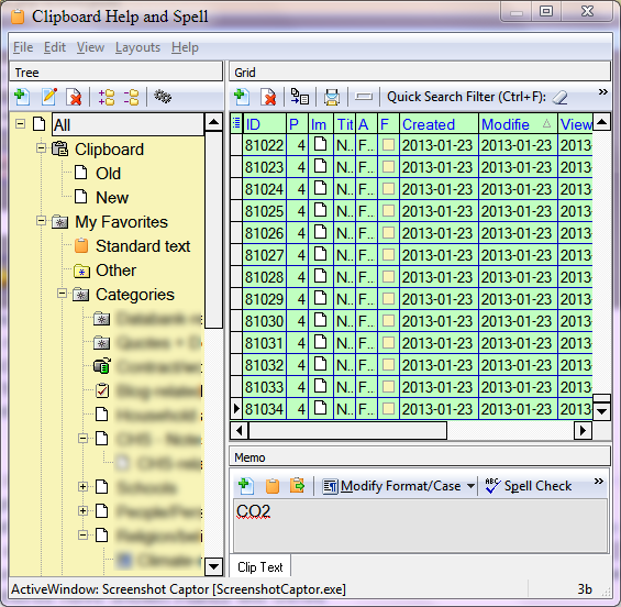

OK, here is a screenshot, taken by Screenshot Captor. The Note field is not displayed.

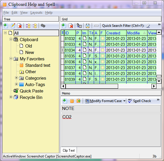

After taking the screenshot, and copying some text, I noticed that the Note field display had come back.

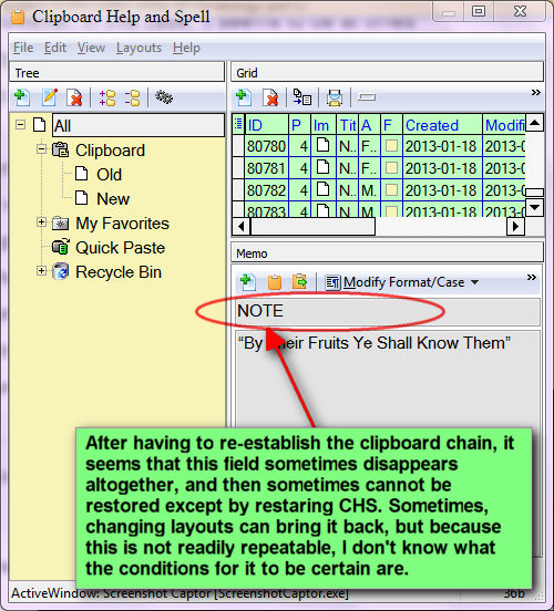

Then it disappeared again, and re-establishing the clipboard chain did nothing to bring it back:

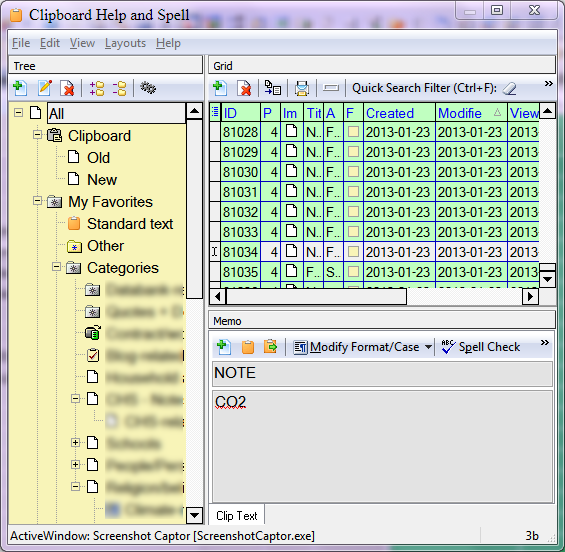

Then, after I had scrolled down the Grid, there was the Note field back again:

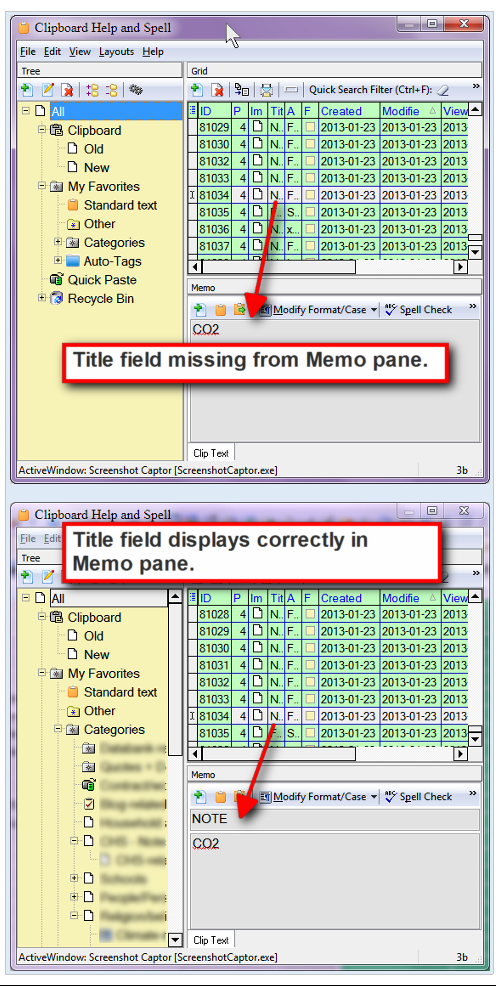

Example of the error:
New information:
The workaround seems to force the Title field to reappear at the top of the Memo pane, and for all clips.
Repeatability:
I have been unable to determine the steps I need to take to cause the error, so, though I have a useful workaround to it that works every time, the error itself is not deliberately repeatable.
The correct description of the error:
The Title field disappears from the top of the Memo pane display.
Details of the error:
  • That field usually has something inserted in it by default - typically (say) the string "Note" (this is adjustable in settings). For example, I currently have it set to the string "Manual Note".
  • The Title field also can be selected for display as a column in the Grid pane display.
  • When the Title field disappears from the Memo pane for a clip, the Title field is still visible in the selected Grid row for that clip, and in all other rows for all clips displayed in the Grid pane.
  • Selecting any different clip row in the Grid pane brings up focus to that clip in the Memo pane, but still without displaying the Title field in the Memo pane. That is, once this error condition occurs, CHS is consistently not displaying the Title field in the Memo pane for any clip selected in the Grid that is brought up to focus in the Memo pane.
Impact of the error on my work:
  • When I mark ("tick") a clip as a Favourite, I invariably have to edit the Title field text in the Memo pane to something relevant to the clip contents - e.g., "Quote by so-and-so". This makes it more readily identifiable when scrolling, and more search-relevant and useful for "capturing" in Virtual Folders using SQL search terms.
  • However, when the error is occurring, the user is unable to edit the Title field in the Memo pane as that field is simply not there to edit, and CHS won't let the user edit the Title field for any clips displayed in the Grid pane.
  • This is a real PITA if it keeps happening when you have a lot of favourite edits like this to do.    :down:
  • The old workaround was to restart CHS and that seemed to fix it for a while - another PITA.    :down:
New workaround:
  • I found this workaround by experimentation.
  • If the error is occurring, then scroll up or down in the Grid pane to the nearest image clip.
  • Select the image clip.
  • Click on the Clip Text tab in the lower left corner of the image pane.
  • This consistently works - it seems to force the Title field to reappear at the top of the Memo pane, and for all clips.    :up:
