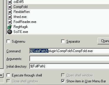

# modify the path to your tools
* go to "Options||Configuration...||User menu"
* modify your paths
e.g. from "C:\Program Files\Servant Salamander 2.5 beta 11\Plugins\Tools\MyApp\app.exe"
to "$[SalaPath]\Plugins\Tools\MyApp\app.exe"
"C:\Program Files\Servant Salamander 2.5 beta 11" is in this case the current working dir
which will be covered later by $[SalaPath].
You will see sooner or later that this $[SalaPath] is not found right now.
Remember, this env var is only valid later, if you have execute the script (respectively the compiled exe)
