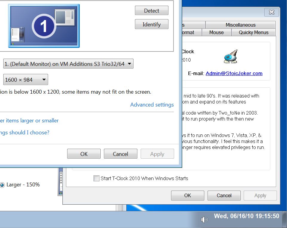

The Properties Dialog showed up right where it was supposed to ... Which is not exactly the result "we" were expection.
So, here is the "score":
Sagji cannot get it to work properly (show up in the right place).
I cannot get it to fail (show up in the wrong place).
  Conclusion: We Really need a third option/party/kind soul/curious bystander to run this thing at 144DPI on Windows 7 to see what it does - because at this point I'm honestly not sure if I'm trying to fix it, or break it.

Okay, as luck would have it, my brother who just moved down here and is staying with us for a while has a 42" TV with a PC input. This gave me a much better test platform for the High DPI bugg. So...
Monitor: 42" Toshiba 1080p HD TV
OS: Windows 7 Professional
Resolution: 1920x1080
DPI: 150
Dialog Position: Where it Belongs... (Finally!)
In case anyone is wondering, the origional code was actually correct, I just needed to add the DPI aware option to the manifest file - which required VS2010. *Sigh* ...I really liked VS2005 better.
Only (other) down side at this point is I'm not sure if/how well it will run on Windows 2000 after being compiled with MSVS2010.
On a brighter note, I can finally get on with some of the other ideas/suggestions that have been mentioned/discussed/requested above.
