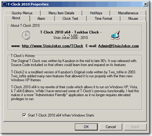

I think I have found what's wrong with the x64 version.
The two versions (x64, and x86) have different manifests. The x86 has both the sections that are in the x64 clock.exe but in the opposite order, and also has a third section that includes the dpiAwareness setting. So it looks like the x64 version isn't set as DPI aware.
sagji
  • Posts: 25
Re: T-Clock 2010 (beta - download)
« Reply #180 on: July 25, 2010, 10:30 PM »

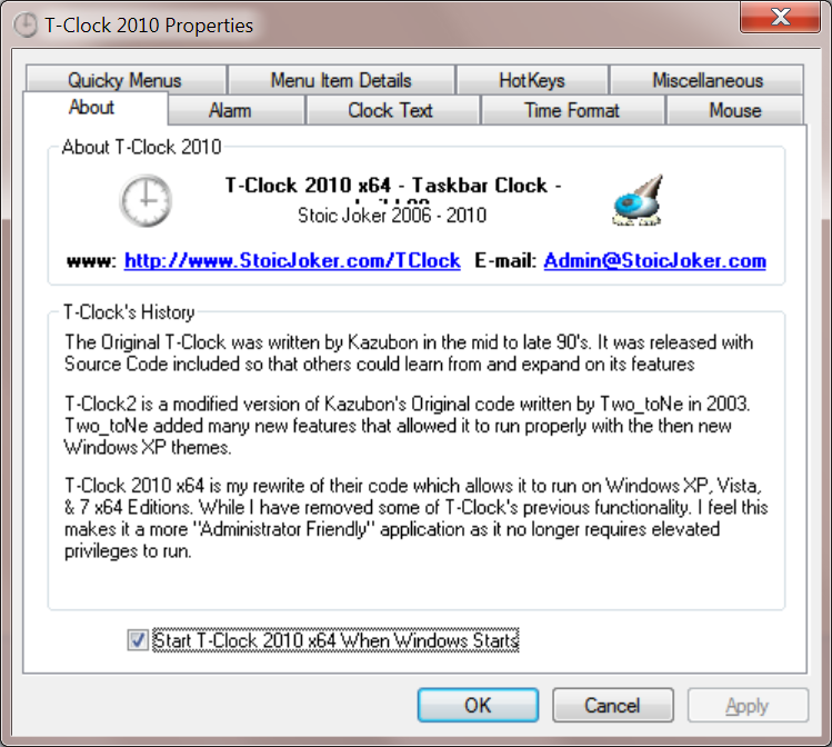

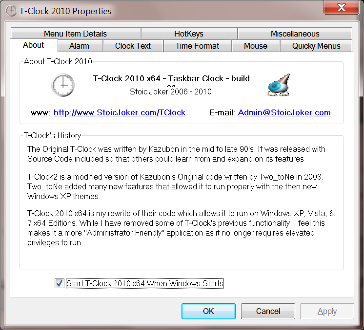

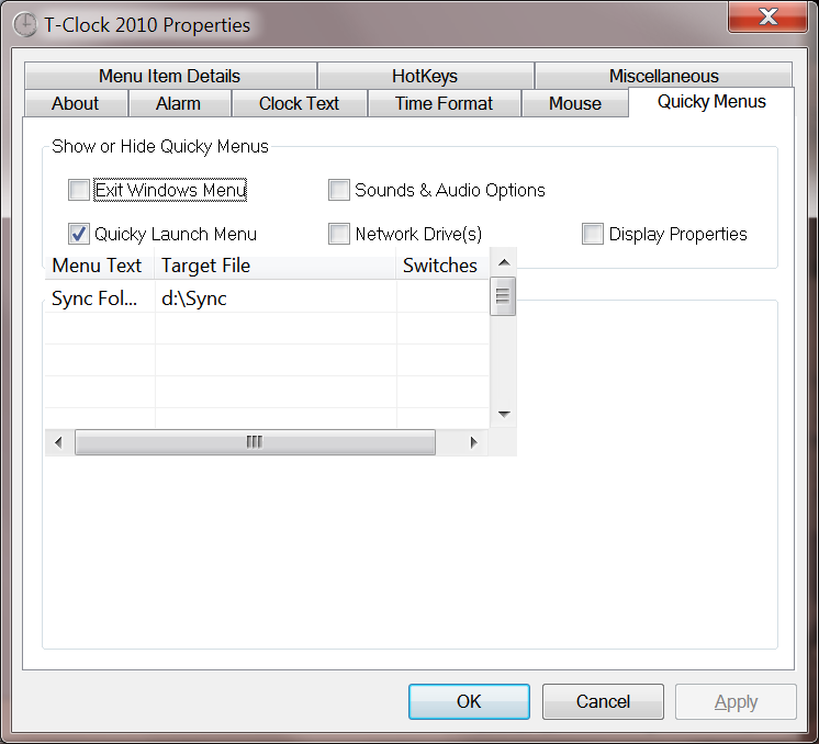

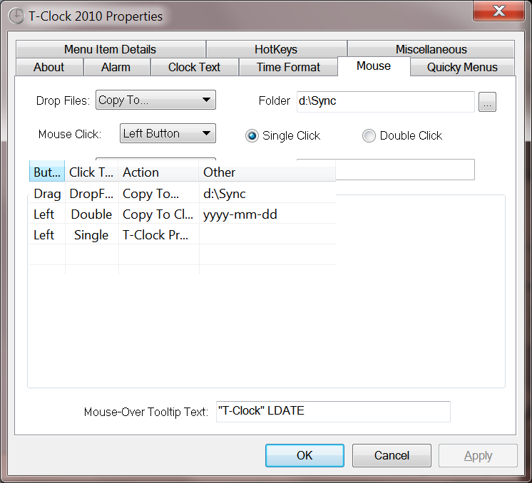

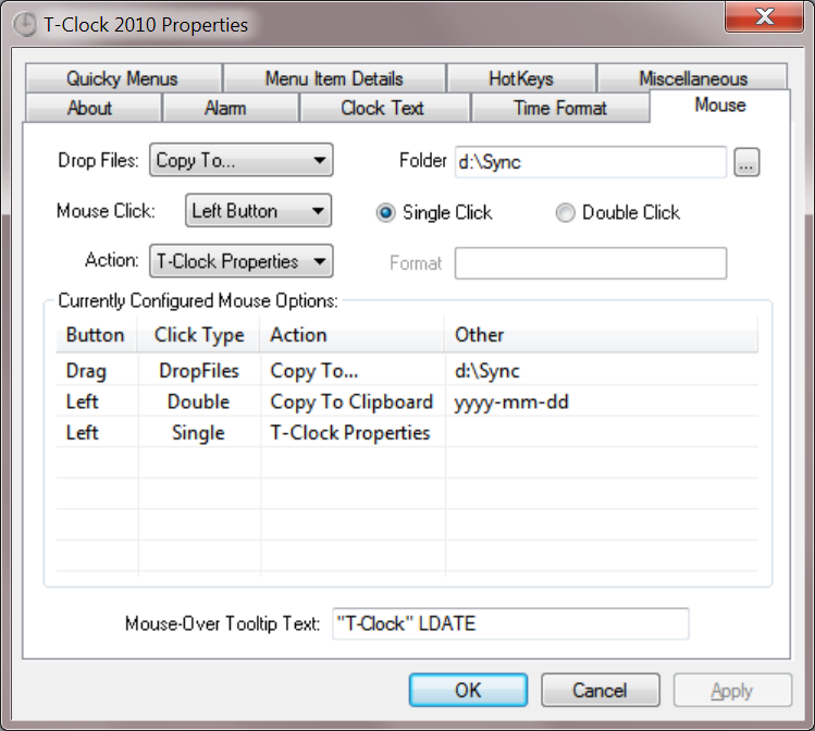

As an experiment I added the DPI aware to the x64 version's manifest.
It now appears in the right place <added> and the calender appears on screen </added>.
But it isn't scaling correctly internally.

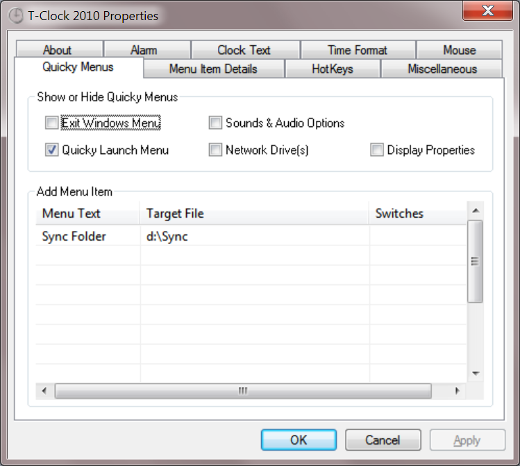

I have attached before and after images for the about, mouse, and quicky tabs - the others appear normal.
In the mouse tab the list of actions starts too soon so overlaps the controls for setting the actions.
In the quicky tab the list doesn't fill the remainder of the page.
The font in the tabs is smaller - so more fit on one line.
The label with the build information fits better but still wraps onto a second line and gets clipped.

:wallbash: Well that'll teach me not to test a 64bit issue on a 32bit box...  :-[
The internal scaling issue I've seen before, I hadn't addressed it yet because you'd never mentioned it -  which has been bugging me (I eluded to it a few pages back) - and I/we/one of us had to get the positioning issue nailed down first. Thanks for finding it.
All of the ListView controls are added/created at runtime so I'll just need to add a routine to size & position them based on current conditions after creation.
Thank you for your patience and assistance in resolving this.

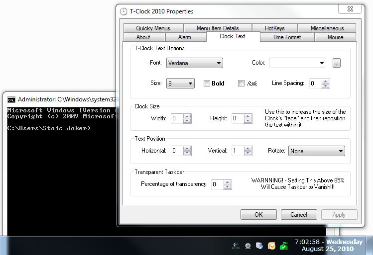

Well... Here's where I'm at (surprised nobody caught this before). I made a change in the way T-Clock creates its-own font at runtime that effectively creates a ClearType font (I was/am debating on making this a configurable option). The native Taskbar transparency is whats queering the deal here, because if you have a dark background the fonts look fine. White or pale backgrounds make the font appear to fuzz.
As an example of this behavior:
Notice it's crystal clear over the command prompt, but it gets fuzzy over the white?
I'm guessing from your screen-shots that you have a light-ish colored wallpaper, Yes?
If you can replicate the test, and confirm this behavior, I'll add including a toggle to the To-Do list so T-Clock's use of ClearType can be disabled internally. *Shrug* ...It seemed like the thing to do at the time - I was shooting for crisper fonts on a dark background - But I have been wrong before... :)
