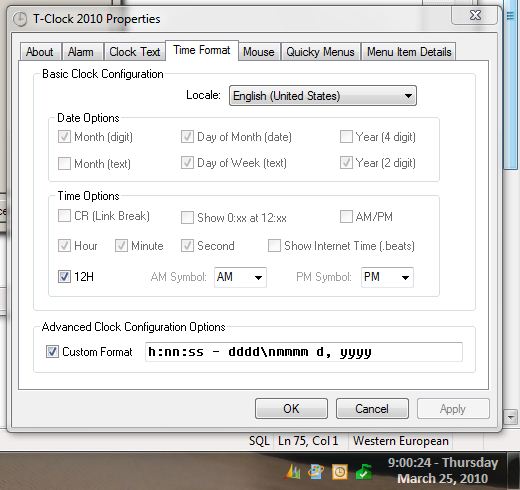

I tried the Stopwatch feature a bit.
I like the lap feature and the ms updating :)
It looks like you can create multiple instances -- is that intentional?
If so, here's something:
1. Open a stopwatch window and move it away from where it appears a bit
2. Press the start button for the stopwatch
3. Open another stopwatch window
4. Press the stop button for the first stop watch
5. Press the start button for the second stopwatch
After step 5, I observe the first stopwatch starting and as you might expect, I expected the second stopwatch to start instead.

Okay, so the farther I get into this the muddier the water gets. It seem that even within the "Standard" there are warring intellectual factions that maintain (rather philosophically) that the first (not week one yet...) part of the year is either end of week 53 - or week 0.
*Shrug* Best I can tell, I'm getting the correct answer for week 1 forward, so I'm gonna go with that unless anybody's got a (documented) better idea. :)
So as it stands now I'm working on 3 variants:
1. ~ISO week starting on Monday
2. ~ISO week starting on Sunday
3. SWN (Simple Week Number)
1 & 2 are already working on test machines, 3 (the "simple" one) is proving to be anything but. However, it will come along (in the next release) eventually - Just as soon as I can find the right sized hammer... ;)

Below is some feedback for: T-Clock 2010 (alpha -5- Release to DC).zip
1. All 3 of the afore mentioned Week-of-Year options listed above.
I haven't tried to grok the week stuff, but FWIW, I put Wm Ws and Ww in a custom format under "Advanced Clock Configuration Options".  What I see currently is:
Code
12 12 12
Perhaps that's working :)  Anyway, just some feedback on that functionality...

Here are the date time formatting settings i use; frankly i don't know why anyone on earth would use anything but these, so i suggest they be made not only the defaults, but the only option available unless the user is willing to hack the executable:
Re: T-Clock 2010 (alpha - download)
« Reply #47 on: March 25, 2010, 01:04 PM »
That seems a bit harsh...even by my (lack of) standards... ;)
That looks like an awfully old build in the screenshot, but in defense (hehe) of alternate settings, here's  my current config at the office.
« Reply #48 on: March 25, 2010, 01:08 PM »
you're right, i screenshotted the old build so i could copy over my settings; the new organization is a nice improvement  :up:
