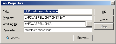

User tools aren't a separate download, if that's what you mean.  You get to them by bringing up CHS's main window, picking a clip, and pressing the [M]odify format/case button.  That brings up a Modify Format/Case screen with User Tools as the middle menu item.  Click that and you get Configure User Tools.  Here you enter any suitable tool you fancy.  One of mine looks like the image below.
The batch file is:
c:\dos\utils\sed-359.exe -f c:\pcw\spellchk\CHS.SED < %1 > %2
and CHS.SED is just a set of search-and-replace pairs, like this:
s/INTERNATIONAL BUSINESS MACHINES CORPORATION/IBM CORP\./g
s/INTERNATIONAL/INTL\./g
s/KABUSHIKI KAISHA/K\.K\./g
HTH, though I doubt it   ;)

rjbull got it right -- there are no predefined user tools to download, it's a mechanism for configuring your own commandline tools to work with CHS.
thanks for the nice example rj, i might put that in the help file if you don't mind  :up:
