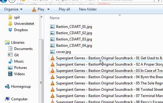

I use Windows 7 -
I request a key(stroke?) that will invoke a media-based program on only the selected items. For example, currently we can select 3 music files, and via the r-clik context menu popup navigate to wmp, release mouse button and it will fire-up wmp and play those three files. Instead, I would like to press a key for same action.
-thank you

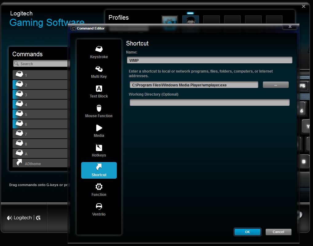

Yes, however it must behave identical to as described in the OP. I want to define several keys and assign different apps (e.g. winamp, wmp, mp3tag, mpc-hc, foobar, etc.). So, perhaps a script for one and highlight the specific terms to change for each different app to do on my own.
fwiw, I have a Logitech G510s with programmable keys. I defined one of them it but did not play the selected files as per the r-clik context behavior. It just started the app. Perhaps assigning the hot-key script
to a "keystroke" rather than a shortcut can work? I don't know, this begins to go beyond my skillset.

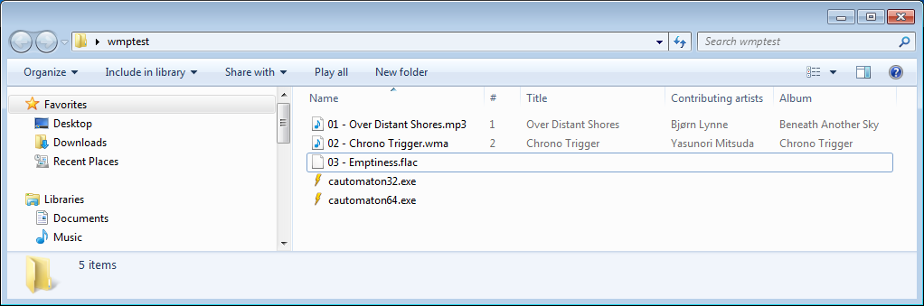

Note that I collected a couple of different file formats: one mp3, one wma, one flac. To Windows, these are all different, and especially once you start dealing with selections of multiple files, you can potentially run into problems where Windows decides to hide entries because it believes a menu item does not apply. You'll note that my FLAC song is not supported by Windows / WMP. I'll primarily focus on the mp3 file in this post, but this serves mainly as a reminder that multiple selections can be very gnarly territory.
You'll see that I put both the 32-bit and 64-bit version in there. Why? Because both versions will very likely show you rather different menus! If your machine and Windows are anywhere close to recent, the 64-bit version should suffice for all your needs... but some programs may simply not show up on one or the other popup menu. Myriads of reasons aside: it is important to be aware of which version you are using if you end up having problems not seeing menu items you should be seeing. My examples will use the 32-bit version of Cautomaton, although you should probably use the 64-bit version because 32-bit is positively ancient. (I made my screenshots before I typed all this, and never gave it much thought. Do as I say, not as I do.... :Thmbsup: )

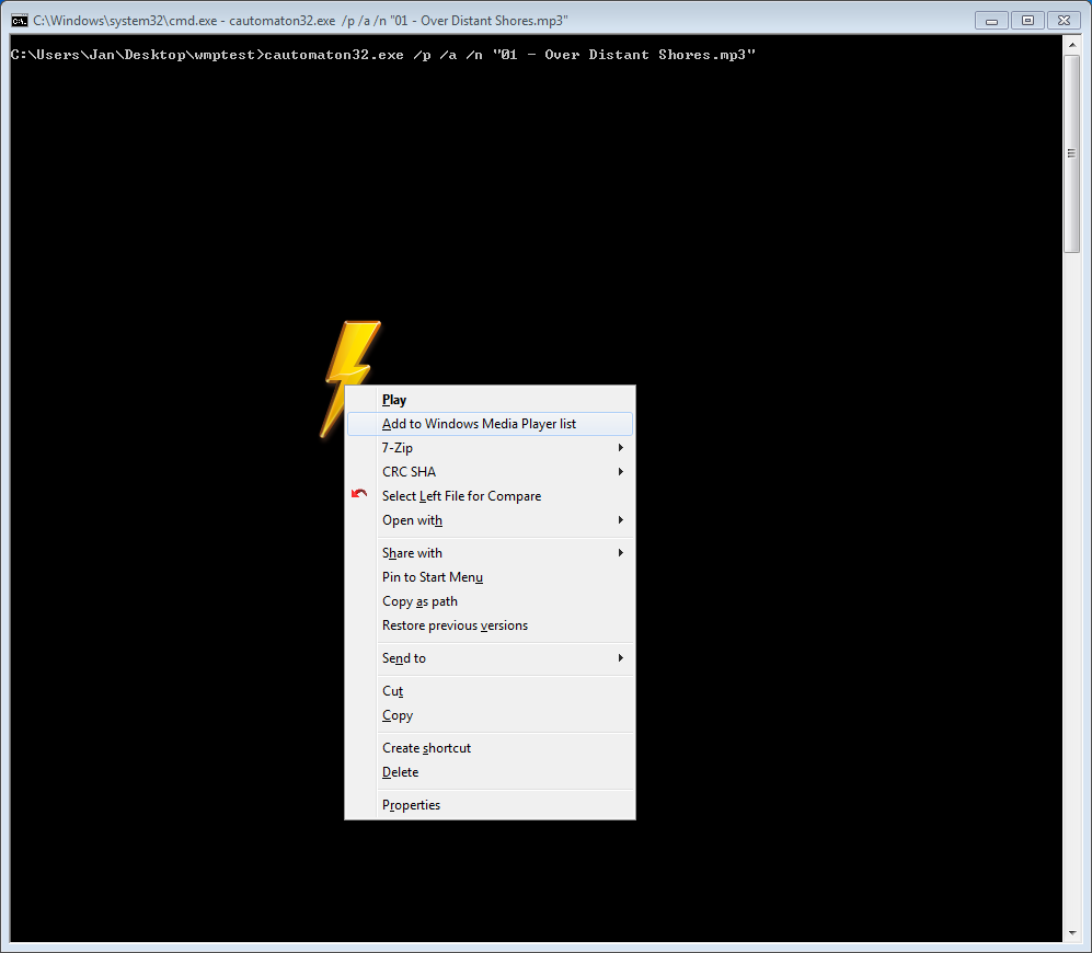

cautomaton-mini-tutorial-2.png"IDEA" : Key to Replace Context Menu R-Clik Program Start On Selected
Here I run Cautomaton with the following switches:
  • /P - this option tells Cautomaton to show a context (popup) menu for human interaction
  • /A - this option tells Cautomaton to run in analysis mode
  • /N - this option tells Cautomaton to not actually execute the chosen action (it is late for me right now and I don't want to risk waking up the neighbors!)
  • my mp3 music file
You can see that I am about to click the 'Add to Windows Media Player' list, because I assume that is the one the OP wants.

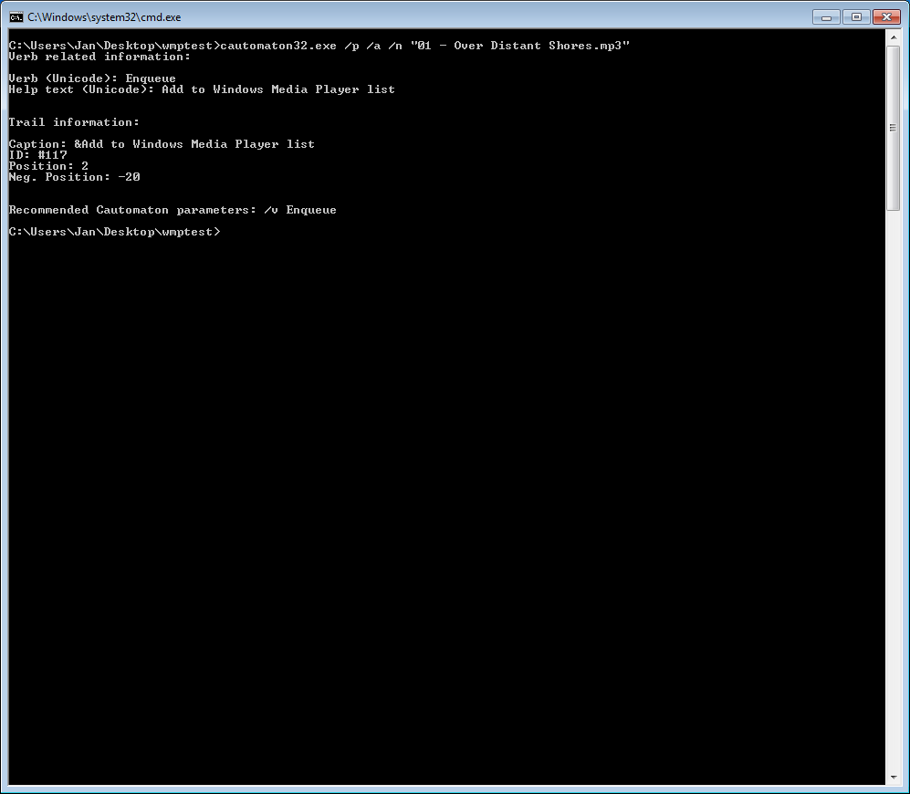

cautomaton-mini-tutorial-3.png"IDEA" : Key to Replace Context Menu R-Clik Program Start On Selected
Analyzing an action will output three pieces of information: information related to the 'verb', information related to the 'trail', and finally the recommended means of reproducing the given action.
Verb related information:
Verb (Unicode): Enqueue
Help text (Unicode): Add to Windows Media Player list
Verbs are the ideal means of interaction as this is a language-neutral concept that is native to Windows itself. They practically exist for the purpose of automation and if present, is always what you will be recommended to use. Verbs are supposed to be the same regardless of you using an English, Dutch, Chinese or Japanese system.
Unfortunately enough, far too many menu options do not offer verbs due to oversights, plain laziness or even because they want to prevent automation. Which is where trails come in.
Trail information:
Caption: &Add to Windows Media Player list
Position: 2
Neg. Position: -20
Trails are a Cautomaton concept based on the idea of having a breadcrumb trail to retrace ones steps. Unfortunately, context menus themselves are not meant for automated interaction, and are very much subject to change depending on the selected files. Some entries change name depending on the file selected. Others can only be pinned down because they like to snuggle in as the fifth item from the bottom. Yet others may be very stubborn about an internal ID.... anyhow, you probably get my point: this is macgyver-esque 'it works for me' and 'do not wake up sleeping bears' territory.
Recommended Cautomaton parameters: /v Enqueue
And finally the recommendation. Thank the gods: it is a verb!
In this case, if we want to reproduce right-clicking the mp3 and choosing this action, the program suggests running:
cautomaton32.exe /v Enqueue "01 - Over Distant Shores.mp3"
And while screenshots can't quite do the music justice ;), I can confirm this works perfectly on my end. (After waking up the neighbors, goddangit!)

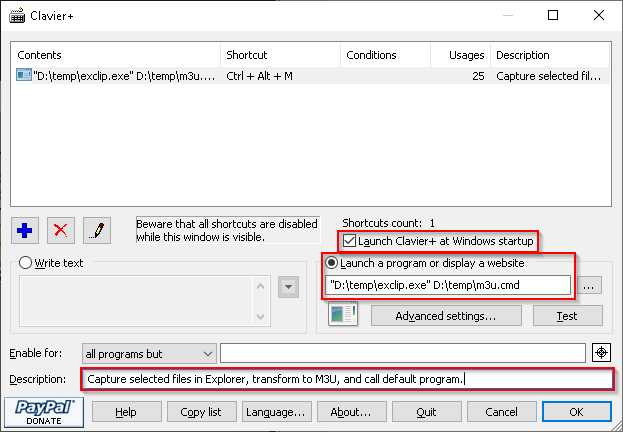

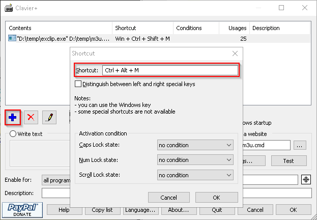

OK, a mish-mash of programs but it works for me :)
  • Download and install Clavier+ (I'll be using this for the example - use whichever hotkey program you're comfortable with)
  • Download the attached archive and put ExClip.exe somewhere
Then see below for setting it all up:
Clavier+ - set up the hotkey to what you want, set the path to ExClip.exe and the auxiliary cmd file as necessary.
2019-04-24 17_53_18.png"IDEA" : Key to Replace Context Menu R-Clik Program Start On Selected
2019-04-24 17_58_09.png"IDEA" : Key to Replace Context Menu R-Clik Program Start On Selected
The cmd file - this is a simple file that takes the text file generated by ExClip and changes it to an M3U playlist file, then calls the default program for it (MPC-BE in my case):

p3lb0x
  • Posts: 424
wat.gif"IDEA" : Key to Replace Context Menu R-Clik Program Start On Selected
Something like this you were thinking off? I set the hotkey to ALT + L in this case and it is hardcoded to open VLC, but with a bit more work it could be configurable with an ini file or something.
Currently I am just running the application with the file names sent in as arguments, so any media player you'd want to run this with needs to be able to do that (or be able to do it with some argument flags)
