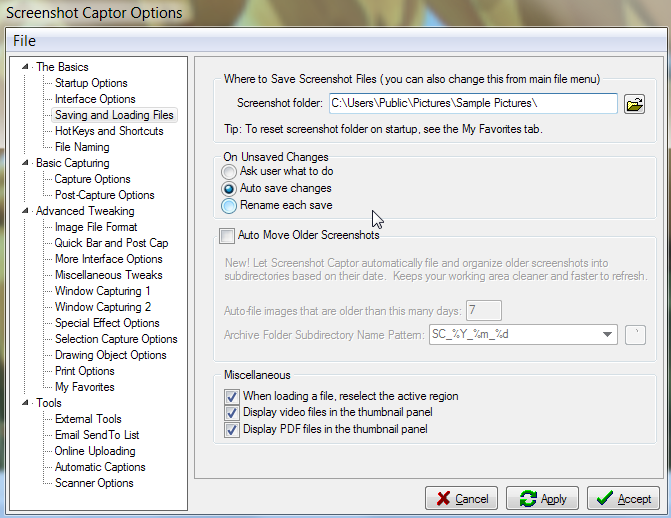

@K Bohne,
first,
my save settings may be different,
second,
I'm unclear what you mean by 'save to my computer'
My settings are 'autosave changes'
Screenshot - 2016-06-14 , 16_53_06.pngSharpen image feature in SSC
below is what I tried and it worked (with those settings)
  • opened Sample Pictures folder (C:\Users\Public\Pictures\Sample Pictures) in filemanager first and created a copy of one of the jpg images.
  • opened that copy in SSC
  • applied sharpening
  • compared with other version, sharpening was saved

« Reply #10 on: June 14, 2016, 07:50 PM »
Thank you Tom
Set settings to auto save
Seems Like that worked even using  a jpg file type
I also noticed the lock and unlock preview button at the bottom plays a part in the same outcome. Not really sure what this button is supposed to do.
I also didn't realize that SSC links directly to computer files when opening the file system. Changes made in SSC change the file on the computer as well.
All good now and Thank you
