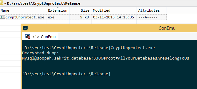

Right, took a look at the MySQL Workbench sourcecode - passwords seem to be stored in workbench_user_data.dat, protected with the CryptProtectData WIN32 API - without any application-specific entropy. So it should be pretty trivial to decrypt - as long as you have access to the user account the workbench was run from :)
Also, from my quick spelunking it looks like the passwords are kept unencrypted in memory, so a process memory dump should also work, although there's the needle/haystack issue with that.
hehe Well... I am the user account the workbench was/is run from, so that part's covered. However I fear we may have slightly different perceptions of what is trivial.. :D ..As I have no where near your background in Crypto. So if you could give me a hint or two on how to hang the code together it would be greatly appreciated.
Here you go, my friend - trivial :)
Without all the file opening and other red tape, it all boiled down to this:
Code: C++ [Select]
  1. std::vector<unsigned char> decrypt(BYTE *input, size_t length) {
  2.         DATA_BLOB inblob { length, input };
  3.         DATA_BLOB outblob;
  4.
  5.         if (!CryptUnprotectData(&inblob, NULL, NULL, NULL, NULL, CRYPTPROTECT_UI_FORBIDDEN, &outblob)) {
  6.                 throw std::runtime_error("Couldn't decrypt");
  7.         }
  8.
  9.         std::vector<unsigned char> output(length);
  10.         memcpy(&output[0], outblob.pbData, outblob.cbData);
  11.
  12.         return output;
  13. }

Worked perfectly - Thank You!!
