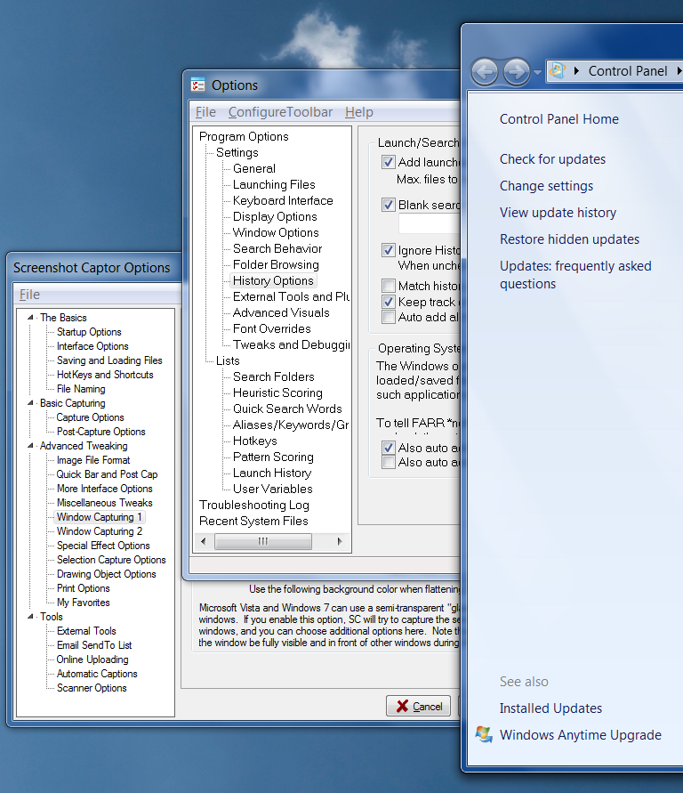

  • Posts: 11,968
Re: CHS is unusable on High DPI Screens
« Reply #3 on: July 30, 2015, 03:39 PM »
mouser I've even been having problems with a FHD 15.6" screen (1920 x 1080).
I have the text @ 125%
Screenshot Captor:
in options, it look like the text is not enlarged.
In the main window, the menu text is correct, but the icons look miniscule, and the text at the top of the viewer pane is cropped (Autofit, etc.)
In FARR's options, the text looks enlarged but there are multiple places where text is cut off or overlapping.
I havent added my lisence yet on this machine, and the popups (on windows start) also have overlapping text (yet the text looks too small to read - will try remember to get a snap when I reboot).

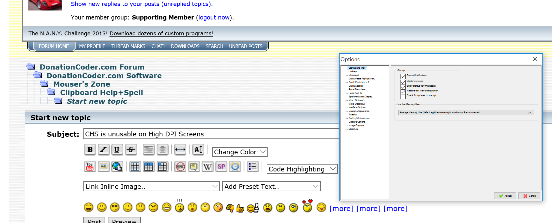

xtabber
  • Posts: 618
« Reply #4 on: September 13, 2015, 12:16 PM »
I'm looking for a clip manager right now and just tried CHS.  This is definitely a problem that would have to be fixed before I could use CHS - it is completely unreadable on my 2560x1440 27" monitor.
See screenshot:Screenshot - 9_13_2015 , 1_00_22 PM.jpgCHS is unusable on High DPI Screens
This screenshot was taken with Screenshot Captor, which is somewhat hard to read, but nowhere near as bad as CHS.  In particular, the SC options screens seem to use slight larger fonts than for those in CHS. Note also that the title bar for the Memo pane in the CHS main windows is not wide enough to fully display the system font which is set at 150%.

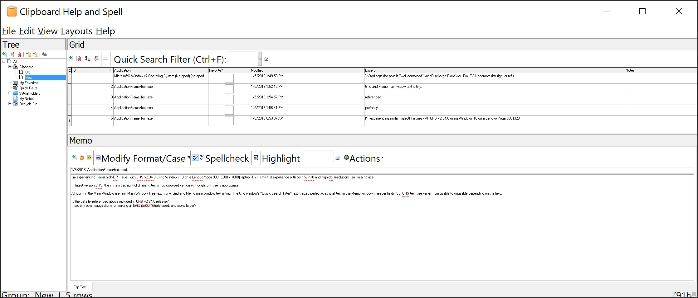

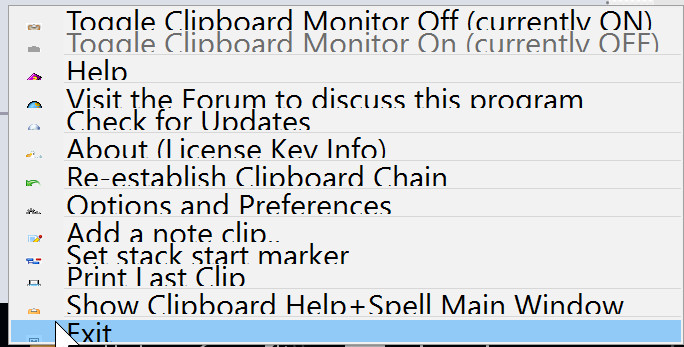

bott3322
  • Posts: 3
« Reply #9 on: January 05, 2016, 03:59 PM »
Please try the new beta:
https://www.donation...dex.php?topic=1514.0
I'm experiencing similar high-DPI issues with CHS v2.34.0 using Windows 10 on a Lenovo Yoga 900 (3200 x 1800) laptop. This is my first experience with both Win10 and high-dpi resolutions, so I'm a novice.
In latest version CHS, the system tray right-click menu text is too crowded vertically, though font size is appropriate.
All icons in the Main Window are tiny. Main Window Tree text is tiny. Grid and Memo main window text is tiny. The Grid window's "Quick Search Filter" text is sized perfectly, as is all text in the Memo window's header fields. So, CHS text size varies from usable to unusable depending on the field.
Is the beta fix referenced above included in CHS v2.34.0 release?
If so, any other suggestions for making all fonts proportionally sized, and icons larger?
Here are screen captures of the right-click system-tray menu, and Main Window:
CHS_Rt_Clk_Menu.jpgCHS is unusable on High DPI Screens
CHS_Main_Window.jpgCHS is unusable on High DPI Screens
« Last Edit: January 06, 2016, 11:04 AM by bott3322 »
  • Posts: 40,926
« Reply #10 on: January 05, 2016, 06:05 PM »
Could I see a screenshot?
bott3322
  • Posts: 3
« Reply #11 on: January 06, 2016, 11:05 AM »
Mouser, I attached them to my original post. Thanks for the help.
