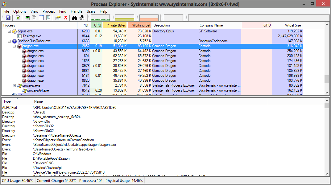

What if you show the Process Memory->Virtual Size column in Process Explorer?
eg.
2015-06-13 13_52_20.pngFree Task Manager total resources for multiple instances?
Actually, while that figure for Dragon seemed reasonable, some of the figures reported by other processes are a bit large.
« Last Edit: June 12, 2015, 11:03 PM by 4wd »
eg.
With chrome the parent process virtual memory is less than even the largest single child, not to mention the sum of the children.  I guess nobody feels a need for it.  Or multi-instance is new enough it hasn't trickled into features.  I guess right now mostly browsers are doing it.  But I think soon many programs will run multiple instances.  At least for desktop programs.

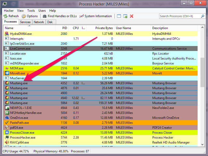

Or, you can use Process Hacker, the latest release (v2.36) include a tray popup window (can be sticky) that show the memory / cpu usage of most active processes,
and for multi-process app show the sum of all process (also for cpu!).

Well, you can try to get something similar with tasklist and an AWK for windows or similar (like advanced calculation using FOR command).
For task manager, try Process Hacker, work quite well.
I have the latest process hacker. I don't see any utility to total the memory usage for process instances.

For Process Hacker, you must hover the mouse pointer on the systray icon of the program for some seconds, and that's show up the window, unfortunately only in this windows the process are grouped.
Re: Free Task Manager total resources for multiple instances?
« Reply #24 on: July 01, 2015, 09:30 AM »
Thanks.  I see it now.  :)
Edit:  btw your script works.  :)
