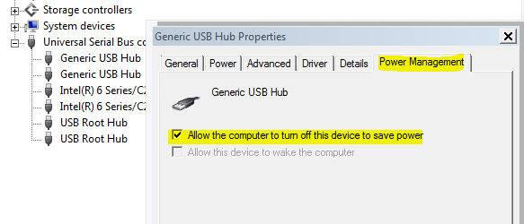

Just to add more, when people say to disable the power saving features of USB, this is what they mean:

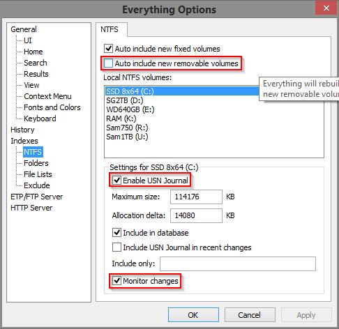

Everything is the problem a lot of the time.
What version are you using?
This used to be a problem with earlier versions, I can't say I've had it since about v1.2.1.451a.
Also, you can set Everything's options to either completely ignore removables, or index but not monitor, (that way it'll index on connection but won't continuously monitor changes) - that might help.
2015-04-24 10_44_49.jpgUSB 3.0 problems with Windows; general discussion
