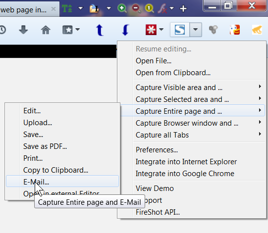

I use Windows Live Mail as my default mail handler. That may not matter, but it seems to work well with any app that can send from the default. Using the 'send mail' from any app will fire up the Windows Live Mail "new message" window, and close after you hit send.
Using Firefox along with Fireshot I think I can do what the request is, except for the hotkey. You can do it from the icon at the top of the browser or from the add-on bar. Fireshot will work in IE and Google Chrome.

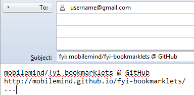

Why not a bookmarklet?
eg. FYI
Just add your email address into it, (this is the Firefox version):
javascript:var%20r='%250A',t=encodeURIComponent(document.title),g=window.getSelection();location.href='mailto:%25s?subject=fyi:%20'+t+'&body='+t+r+location.href+r+(g?'---'+r+encodeURIComponent(g)+r+r:r);void'2.6ff'
Change to:
javascript:var%20r='%250A',t=encodeURIComponent(document.title),g=window.getSelection();location.href='mailto:[email protected]?subject=fyi:%20'+t+'&body='+t+r+location.href+r+(g?'---'+r+encodeURIComponent(g)+r+r:r);void'2.6ff'
It'll open in your default email client with address, page title as the subject, with the URL and any selected text in the body.

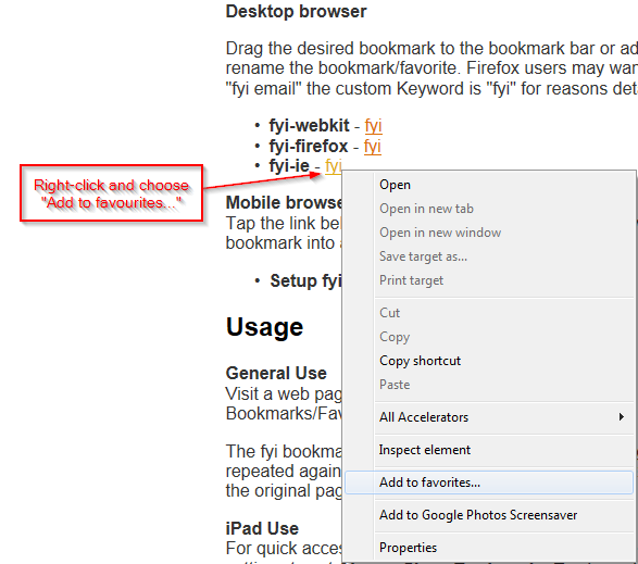

  • Posts: 5,650

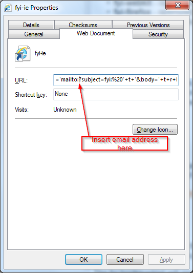

If it's IE we're talking about:
2013-11-24 16_11_20-.pngFile Send Link by email as a Single Hotkey without having to leave the webpage
When it's in your Favourites, right-click on it and select Properties:
2013-11-24 16_24_47-fyi-ie Properties.pngFile Send Link by email as a Single Hotkey without having to leave the webpage
2013-11-24 16_14_48-mobilemind_fyi-bookmarklets @ GitHub - Internet Explorer.pngFile Send Link by email as a Single Hotkey without having to leave the webpage
That should work so that the next time you click the link it will insert your email address - I can't test it as IE is neutered, it requires you have a default email client set on the system, which I don't.

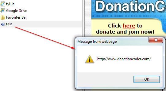

EDIT: Current page is held in JavaScript document property, eg. if you create the following bookmark and then click it a window will open with the URL.
2013-11-24 16_36_39-Properties for _Browser window position reset_.pngFile Send Link by email as a Single Hotkey without having to leave the webpage
2013-11-24 16_44_39-DonationCoder.com - Internet Explorer.pngFile Send Link by email as a Single Hotkey without having to leave the webpage

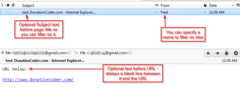

IE Address Emailer (IEAE)
Edit the .ini file to use your SMTP server and details, there's an example .ini for SSL, (eg. Google), and non-SSL servers - the only difference is the port and the SSL flag.  The .ini needs to be in the same folder as the executable and have the same main name, eg. IEAE.exe = IEAE.ini
Works with Internet Explorer, (only tested with v11), and Firefox, (only tested with Pale Moon/Thunderbird), and doesn't require an email client to do it's dirty work.
You can run it by clicking on it's icon, through the CLI or assign it to a hotkey, (note: it doesn't set or use any hotkeys itself).
By default it looks for Internet Explorer, if you want to use it with Firefox add a parameter starting with f, eg.
IEAE.exe firetruck
When run, it finds the IE/Firefox window, grabs the title and the URL, sends the email, and then exits.  The only time a window is opened is if there is an error sending the email.
For Firefox, the browser will be brought to the front and the URL copied to the clipboard before being emailed, (easiest way to do it).
Subject gets truncated to 70 characters + ...
Naturally, you'll need to allow it through your firewall.
Source is included just so you know I'm not stealing your email addresses

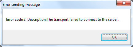

OK   I neutered Bit Defender on ieae and now I get a transport error.  One of those long codes but at least I got something  said error code 2.  The name is right.  smtp server is right.  pw is right.  port is right
Any idea where to go from here?
  • Posts: 5,650
You mean like this:
If so:
And don't forget:
Otherwise, I'm going to need a lot more info.
Or, just create a free GMail account to use for sending since I know it works fine with them.
« Last Edit: November 25, 2013, 05:18 PM by 4wd »
