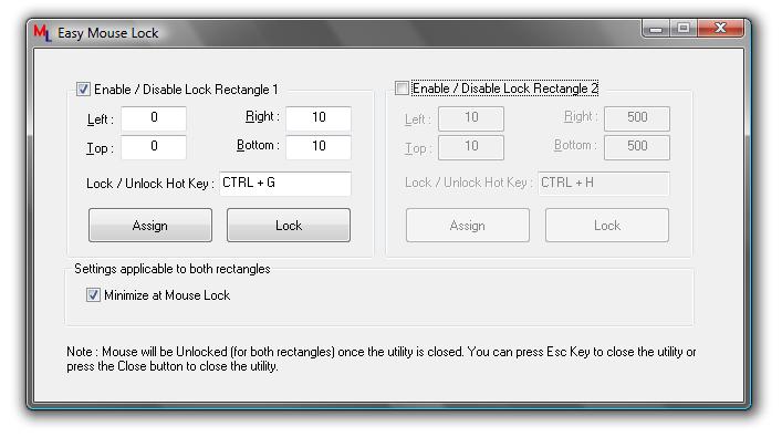

What I think I need is a tool which restricts the movement of the cursor to a slightly smaller area than my desktop, e.g. to 1280x1022 instead of 1280x1024. That way, hitting the bottom of the mouseable area would always trigger any Taskbar button or Trayicon underneath.
Oddly, I'd already found what would be the perfect tool for this problem, if only it worked better ...
Lock Mouse Cursor with Mouse Lock Utility
 Use given below software utility to lock your mouse cusror within defined rectangle / area. Define upto two rectangles to limit the mouse cursor movements. Lock / Unlock Mouse Cursor with a simple key press within defined rectangle or close the Mouse Lock application to unlock mouse cursor and allow the mouse cursor to freely roam on your computer screen. You can even enter whole desktop width and height to limit the mouse cursor movement, which in turn can be helpful in a dual monitor computer setup avoiding mouse cursor movements to the other monitor / display. Free to try download of Mouse Lock utility allows to Lock Mouse Cursor upto 20 times.  Download Trial Version of Easy Mouse Lock utility now and try it for free.
It does exactly what I was after. Alas, with it running, the cursor moves around any edge of the desktop as if it has been coated in treacle, which is a cure worse than the ailment.
