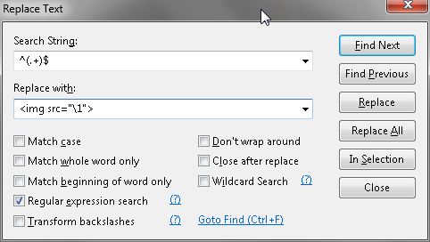

I would think that any decent text editor that allowed RegEx search/replace could handle that.
eg. Notepad2-Mod
^(.+)$ - Search for and put everything between the start, (^), and end, ($), of a line into a group.
<img src="\1"> - Replace with <img src=", followed by the original contents of the line \1, followed by ">.
Seemed to work fine here.

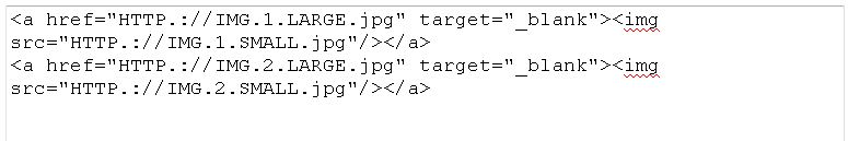

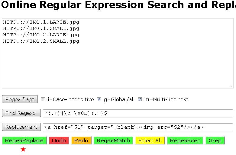

Addendum: Here's an online multi-line RegEx text editor.
And if you set it up like so:
2012-07-23_16-04-29.jpgSOLVED: Insert text string to front / end of each line in a text file
Then click the RegExReplace button, (*), it will do what you want all in one hit :)
2012-07-23_16-04-14.jpgSOLVED: Insert text string to front / end of each line in a text file
NOTE: They use $ instead of \ for specifying backreferences, eg. $1 i.l.o. \1
