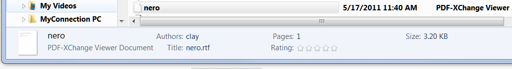

When Windows Explorer opens the Documents library (on Win 7 x64) everything appears normal but there are some files that when you double click to open them they cause Windows Explorer to freeze and you have to use task manager to restart Explorer.
Oddly it doesn't seem to be file type specific and there don't seem to be any problems if you are working in subfolders of Documents.
Never come across this before.
Initially I ran CHKDSK on the drives where the Documents library folders are located and it made no difference.
It could be a Shell Extension issue but why are only some non typ-specific files affected and only in the Documents folder root? I would expect a shell extension problem to affect all specific file types.

Seem to be mostly MS office files (but seems random which ones cause the problem). I have run a Repair install of Office 2007 which should fix file associations etc. just rechecking now.
I used ShellExView to disable all non-MS shell extensions and that didn't fix it
Just running SFC /SCANNOW
The annoying thing is the only logged error is Windows Explorer stopped interacting with Windows - doesn't give any clue why. It says look in the Action Center for futher info and that says there are no issues!

Seem to have fixed it.
I have found this problem in all versions of Windows since 98.
Basically what had happened is that an application had saved some files in deep nested subfolders and the file names are too long.
This seems to bugger up the file system and cause odd/random effects.
Basically I removed the folder from the Documents library, copied everything I could to a new Documents folder (and left behind the files with bad names) and then made that the default docs folder.
All seems to work fine now - but I have 19 files in the old folder which cannot be moved.
The really stupid thing is I would have thought this is precisely the sort of error CHKDSK was designed to resolve!! (Not that it should be able to happen in the first place).
