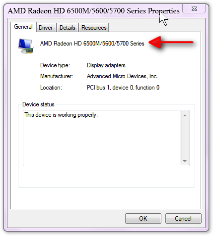

I have an HP Envy 14. The specs say it has:
  • ATI Mobility Radeon HD5650 1GB Dedicated Graphics
  • Intel Core i7-720QM 1.60GHz Quad Core Processor - Actual: 35W turbo processor (1333-MHz FSB, 6-MB L3 cache).
The O/S is Win7-64 Home Premium.
Initially, I was finding the screen much too "glary" and could not find in Help, nor figure out, how to adjust colour, brightness, contrast or gamma settings. Stumped, I googled the problem and stumbled upon a website where someone had been having identical problems and said that he found a brightness and other adjustments inside the AMD driver utility package CCC (Catalyst Control Centre), which was already installed on his laptop. It was installed on mine too, and it worked very well!     :Thmbsup:

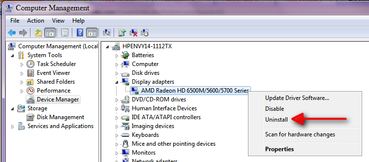

Having run out of ideas, I wondered whether maybe the existing installed driver might be blocking the upgrade installation.
So, rather nervously, I removed/uninstalled the driver via the Computer Management Console:
That left me with an 'orrible-looking display.
I reran the upgrade installer, it got a bit further along this time, but still hung, so I killed the process.
So, I got Windows to scan for new hardware, and it reinstalled the (previous) display driver.
This returned me to the state at the end of STEP #2.

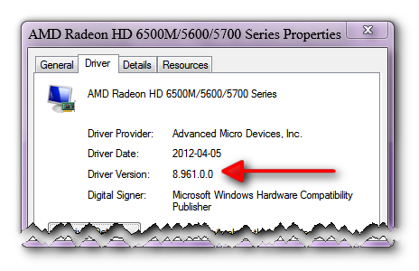

So, with ATI Tray Tools installed, I used the .msi driver installer buried in AMD's latest (v12.4) driver/CCC installer package (I was tempted to try AMD's latest ß release version from NotebookReview.com, but decided on caution), and installed the very latest stable driver.
So I was left with the latest driver installed (v8.961.0.0) and the display adjustment capability that I needed. Success!     :Thmbsup:
