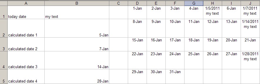

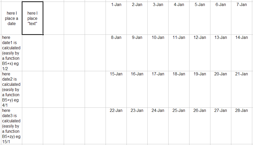

in case I didnt make it clear, I attach some screenshots of what I have at start and of what I should have at end:
START:
END:
any idea? can a function or a macro or anything else do it?

my requirements are nothing more than what I mentioned in my previous post, I mean, I exactly and only do what I mentioned previously
if you have any specific question, I will be glad to answer
I was thinking to use an "append" function or macro, but I don't know how to start
the target cells appear to have date format in the screenshot, but this is not necessary imo, there will be no problem them being simple text
but the "calculated dates" must be in date format, because they will update according to the date I have set as "today date"
in simple words, the script/macro or whatever, will have to take "my text" and append it to the correct calendar cell
it would be really nice if inside the calendar cells (that will contain the date at top and the appended text at bottom), the date is highlighted, formated or somehow distinguished from the other text below, so that it would be easier to the eye to see which text correspond to which date
or maybe each date cell in the calendar should be splitted into two cells, one containing the date only and the other (below) containing the appended text
last, a shortcut or button preferably should trigger the data migration/binding across the cells (from source "my text" cell, to target cells of the calendar, with calculated dates as pointers)

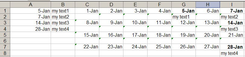

See attached for an attempt (zipped - xlsx attachments not  allowed on DC)
Note that:
1) It is a bit more general than your example (every date can have different text).
2) It does not move the data - it references it (I personally do not like destroying data - and moving the data MUST be done with a macro - this is pure Excel)
3) It has a hidden line 1 and hidden column C - required to calculated the dates properly.
4) You can change the format of the date displayed (change DD-MMM in the formula to the format you want)
5) If you want an empty line between the date and the text, add another ",char(10)" (right before/after the first)
6) Cells MUST be formatted as wrap text, otherwise text will appear on a single line (i.e. linebreaks will be ignored)
7) Created using Excel 2007 - but should work in other versions as well, nothing special done

Sorry - version 2 was easier than I expected
1) Does bold formatting - but uses conditional formatting of Excel 2007 - may not work properly in Excel 2003 or earlier
2) Puts the text in a new row
3) Less complex than the previous version

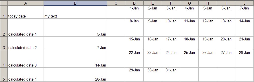

can you tell me what to do to reproduce it, because I have EXCEL 2003 and because I need to customize it a bit?
thanks!!

it is not exactly what I need and I think I cant make it by my own to be as the one I need, so can you help me with this please
the steps the user will follow are these:
1) place a date at "here I place a date: (this will make some dates be calculated below)
2) place your text at "here I place some text" (this will make the text append at the correct date in the calendar at right)
any hint?

DC Excel3 gives me this screenshot:
which is not the same as the one I posted above
is this due to 2003 vs 2007 conversion or I miss something?
