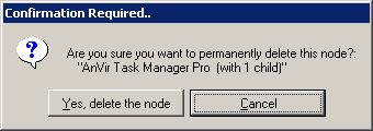

I've now installed version 1.124.01 and tried to delete just one child node.  In fact, I tried to delete the AnVir Task Manager node pictured in an earlier message, since it was located right under the parent node ("Very Useful").  I was asked whether I was sure I wanted to delete this node (i.e., AnVir).  The only strange thing is that the box with the question seemed to claim that the AnVir Task Manager node had one child node (see screen shot).  I assume it thinks there's a child node that will be deleted along with the AnVir Task Manager node, but there is no child node.  Have I misunderstood what this means?
At any rate, I said yes, I was sure I wanted to delete the AnVir Task Manager node with one child node.  I was happy to see that only the AnVir Task Manager node was deleted, not the other 188 nodes in my LBC.  I don't know whether this tells you anything useful, but at least it means I can continue to use LBC without worrying that deleting one node will delete them all.  (But yes, I will continue to be obsessive about backing up to my flash drive.)

Thanks for the report and the note about the child counts being off by one.
What i found when putting in the new warnings before deleting is that it was very easy to select one node, and then right click on a DIFFERENT node to get the context menu and choose delete, and the node that would be deleted was the previously selected node, NOT the node you right clicked on.  So I think that might have been what happened to you.  Now when you right click on a node it is selected first before the context menu comes up, so i think that should solve the problem.
