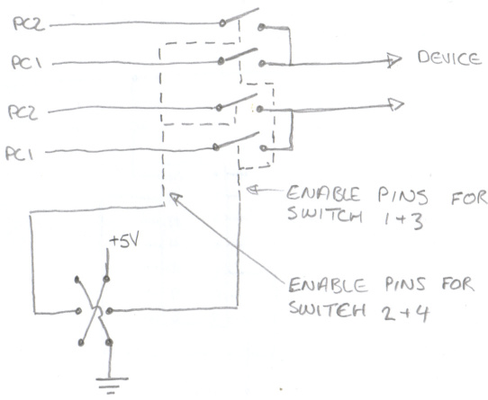

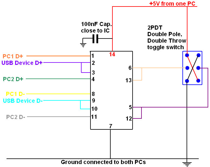

« Reply #12 on: December 30, 2010, 04:06 AM »
Here's a circuit using a Quad Bilateral Switch, CMOS or TTL they are pin compatible - although the TTL would need to be 74HC or 74HCT series.
Parts:
4066 CMOS or 74HC4066 or 74HCT4066 (use a IC socket)
DPDT toggle switch
100nF MKT capacitor
You could wire up the whole thing on the back of the IC socket.
Here's the functional sketch bit:
The only thing I'm not sure about is whether the internal parameters of the IC will allow full 480Mb/s without degradation but it's a simple circuit so if it doesn't perform satisfactorily then there's always the rotary switch method ;)
The other thing I have is a Belkin Flip, haven't tested it yet but I don't see why you could just not use the monitor port, connect the keyboard to one of the USB ports and a self-powered hub to the other.
If you're interested I'll give it test - I don't use it anymore since I use DVI connectors now.
