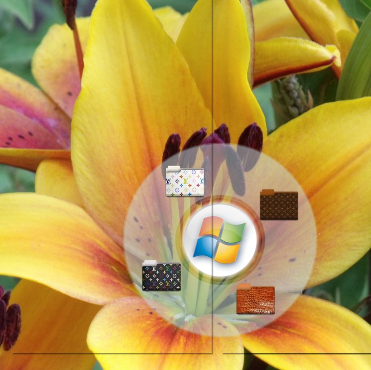

Hi,
I have the screen remnant shadow problem when using the centre button for the start menu.
I'm using Vista 64bit service pack 2
Circle Dock 1.5.6.30
Net Framework v2.0.50727 - 64

Greetings ZigZag  :D
Welcome to donationcoder.com. Home to Circle Dock and so much more  :Thmbsup:
I am looking at the image, and I am seeing what your are seeing, but I must admit to being stumped. This is teh first I have seen of this.
Does this happen with any icon or Background, or just the ones shown in your supplied image.
Let em know  :tellme:

« Reply #2 on: May 17, 2010, 05:48 PM »
Hi,
It happens with any icon or background. I've just tried a clean uninstall (deleting all the circle dock registry keys and folders in AppData etc) and then re-installing but it's still the same  :(

Re: Start Menu Shadow Residue Bug
« Reply #5 on: May 18, 2010, 08:59 AM »
The problem with the Start Menu leaving an outline of its shadow is well-documented. This only affects Vista and the work around is to disable menu shadows in your Display Preferences (Control Panel).
