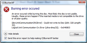

This morning i decided to catch up on my DVD Archiving.. and got a huge surprise, Nero erred out on me.. so i switched to CDBurnerXP.
erred out again..
the burner still reads fine, and it was burning fine the last time i used it.. couple of months ago.
unfortunately I've installed/removed tons of software lately including intel chipset driver updates. which i tried downgrading.
I've wasted 20 DVDs trying to find the solution.
Is there a better way to test if i fixed the problem without wasting DVDs and hence cash?
I tried googling the error and found a similar problem that was related to the chipset drivers, but couldn't find much else....
anyway attached is my sys info and a cap of the error from CDBurnerXP, please please help me get this up and going.. i can't afford a new burner, and really want to avoid a format/reinstall. as my backup is corrupted, drives are near full. i tried the one restore point i had and that was corrupt to... :(

Use ImgBurn and check tools->Filter Driver Load Order. That will let you see filter drivers attached to the CDROM class... if there's nothing suspicious there, it's most likely not a software issue.
well i thought it may be a s/w issue because a) the drive still reads b) i updated the chipset drivers in between the last working burn and this problem.  c) hope.
I am starting to believe that the drive is just dead though... I can't find my live CD to test it under there. and  after flashing the drive ImgBurn gave me this:
ImgBurn
DeviceIoControl(FSCTL_LOCK_VOLUME) Failed!
Device: [0:0:0] Optiarc DVD RW AD-7170A 1.04 (G:) (ATA)
Unable to lock volume for exclusive access.
Reason: Access is denied.
Hint: You've got another program running that's using the drive, close it and then click 'Try Again'.
though nothing else was running nor should have been using the drive, so i told imgburn to ignore exclusive access in the settings and it gave me :
0:23:55 Source File Volume Identifier: 20070518
I 10:23:55 Source File Application Identifier: PCLinuxOS release (PCLinuxOS) for Live CD
I 10:23:55 Source File File System(s): ISO9660 (Bootable), Joliet
I 10:23:55 Destination Device: [0:0:0] Optiarc DVD RW AD-7170A 1.04 (G:) (ATA)
I 10:23:55 Destination Media Type: DVD-R (Disc ID: CMC MAG. AM3) (Speeds: 2x, 4x, 6x, 8x, 12x, 16x)
I 10:23:55 Destination Media Sectors: 2,297,888
I 10:23:55 Write Mode: DVD
I 10:23:55 Write Type: DAO
I 10:23:55 Write Speed: MAX
I 10:23:55 Link Size: Auto
I 10:23:55 Test Mode: No
I 10:23:55 OPC: No
I 10:23:55 BURN-Proof: Enabled
I 10:23:56 Filling Buffer... (40 MB)
I 10:23:57 Writing LeadIn...
W 10:24:35 Failed to Write Sectors 32 - 63 - Reason: Logical Unit Communication CRC Error (ULTRA-DMA/32)
W 10:24:35 Retrying (1 of 20)...
I 10:24:35 Writing LeadIn...
W 10:24:35 Failed to Write Sectors 64 - 95 - Reason: Logical Unit Communication CRC Error (ULTRA-DMA/32)
W 10:24:35 Retry Failed - Reason: Logical Unit Communication CRC Error (ULTRA-DMA/32)
W 10:24:35 Retrying (2 of 20)...
W 10:24:35 Retrying (3 of 20)...
W 10:24:35 Failed to Write Sectors 128 - 159 - Reason: Logical Unit Communication CRC Error (ULTRA-DMA/32)
W 10:24:35 Failed to Write Sectors 160 - 191 - Reason: Logical Unit Communication CRC Error (ULTRA-DMA/32)
W 10:24:35 Retrying (4 of 20)...
W 10:24:35 Retrying (5 of 20)...
W 10:24:35 Failed to Write Sectors 192 - 223 - Reason: Logical Unit Communication CRC Error (ULTRA-DMA/32)
W 10:24:35 Failed to Write Sectors 224 - 255 - Reason: Logical Unit Communication CRC Error (ULTRA-DMA/32)
W 10:24:35 Retrying (6 of 20)...
W 10:24:35 Retrying (7 of 20)...
W 10:24:35 Retrying (8 of 20)...
W 10:24:35 Retrying (9 of 20)...
W 10:24:35 Retrying (10 of 20)...
W 10:24:35 Failed to Write Sectors 256 - 287 - Reason: Logical Unit Communication CRC Error (ULTRA-DMA/32)
W 10:24:35 Failed to Write Sectors 288 - 319 - Reason: Logical Unit Communication CRC Error (ULTRA-DMA/32)
etc etc etc...
i looked @tools->Filter Driver Load Order and it looked OK to me, so i guess I'm going to save up for a new drive. are lite on good?
