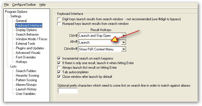

the reason might be the settings as seen in the screenshot.

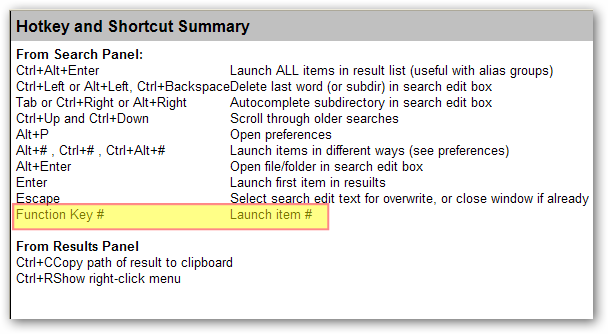

as it happens to be, the function key is involved in launching items. anyway to close Farr, you can either press Esc or Pause key.
https://www.donation...shortcut_summary.htm
