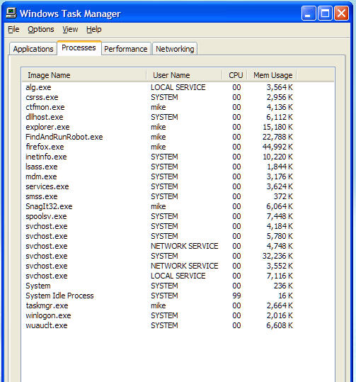

I do have it working correctly on a new computer with nothing but XP Pro SP 2 installed (and ff and farr).  But on my home, office, and laptop machines (also XP Pro SP2), I just can't get farr to un-minimize ff.  I uninstalled every ff add-on one at a time, and then finally wiped the ff directory and reinstalled ff.  With no ff add-ons installed, I then removed app after app from the Task Manager, startup apps, and anything that was not running on the other (working) XP machine.  Does anyone see anything else worth killing off?
