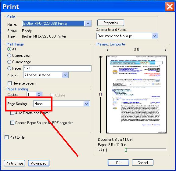

HOWEVER,  I figured out a workaround.  As your software prints fine to "fax," I installed a free opensource PDF writer from:
http://www.bullzip.c...roducts/pdf/info.php
I printed the book to PDFs and then printed those fine.  NOTE:  I cannot speak for all PDF writers, but the one I have automatically scales the image to the "print area."  This results in a shrunken printout that does not match the Avery business card template.  This is easily corrected by turning the print scaling to NONE in the print dialog window.

Here's the PDF print dialog box showing what the setting should be.
