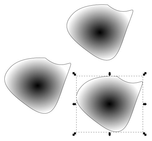

they look exactly the same when pasted back in Inkscape.
Here three different (should be identical) clips:

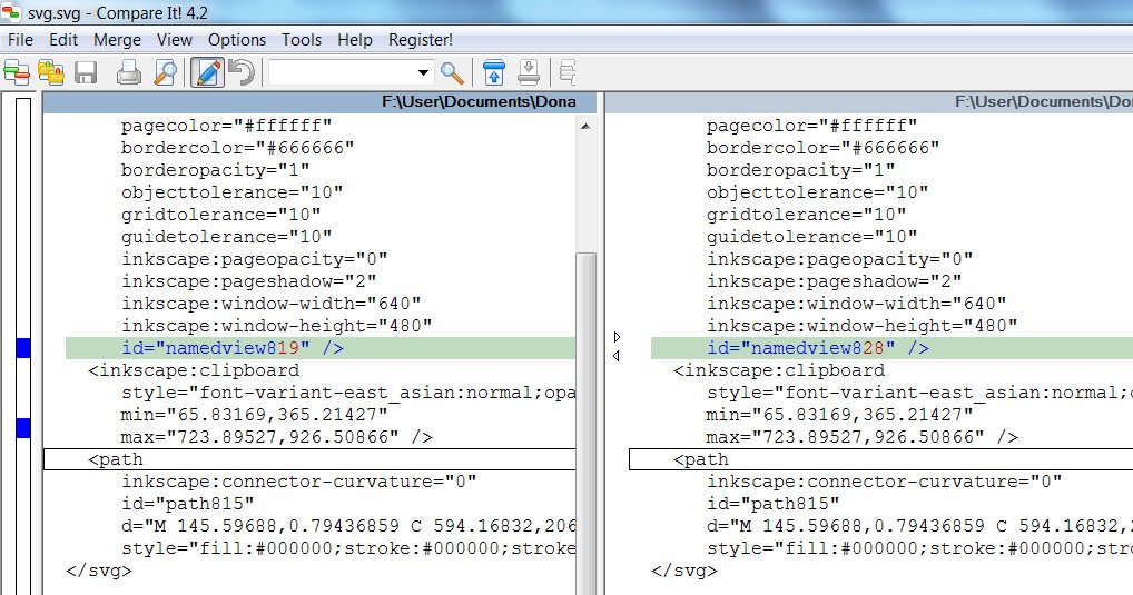

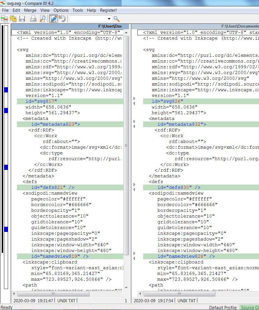

The files that are different are the svg files.
on the left from folder chs1, right is chs2
Clips look identical when pasted.
This looks to me like Inkscape is titling all 'id numbers' differently. I guess that could be filtered, (please note for me this not so important -- I'm going to save clips occasionally to favourites. Beyond that I wont mind duplicates... Willing to keep checking though if you want: my main machine is down so currently no access to illustrator.
No, that solves that issue.  I think for the most part its no big deal if you get duplicates.
