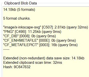

Next version will include a little clipboard viewer tool you can bring up:
« Last Edit: February 21, 2020, 11:01 AM by mouser »

New version uploaded, with clipboard blob viewer.  You can access it through the View menu.. Let me know what you think and of course report any bugs.

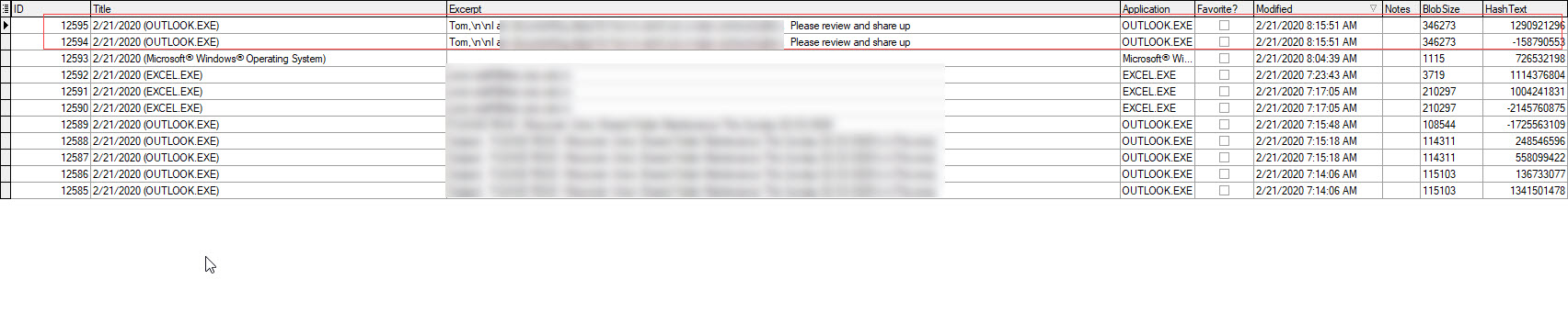

Could we get some scroll bars on the HTML Source preview tab? (and any other tab that doesn't have them)  Thanks.
I am also seeing duplicate clips, although I'm not sure it's all that big of a deal.  Would be nice to get it collapsed down into one, though.  OR, does the grid control you're using support multi-level (aka grouped) entries?  If so, you could put clips that have multiple captures in an expandable row.
Example duplication:
Awesome updates so far!  THANK YOU for the effort and all the new features!  8)

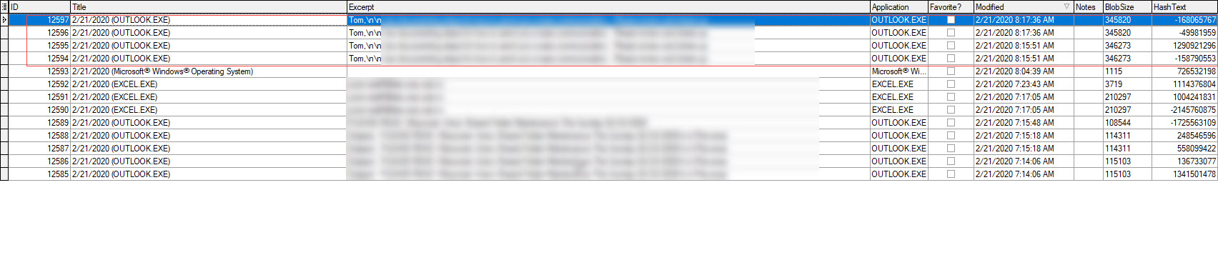

Here's an interesting twist.  After I posted the last screenshot, two more of the exact same clip showed up out of nowhere spaced a couple of minutes from the original two.  :huh:

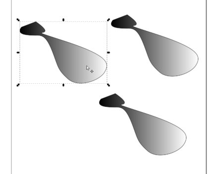

Mouser, this all just reporting CHS treatment of vector clips -- summary: it appears to work correctly but still saves duplicates.
Testing with Inkscape 0.92.4 (5da689c313, 2019-01-14)
  • With Clipboard Trigger Copy Delay set to 400ms, two clips get copied (1 x Ctrl+v).
  • With the same vector drawing and delay set to 500ms -- one clip gets copied.
Also note: Clips remain duplicated (setting is to update clip)
All clips appear identical when pasted:
The only difference in blob info is time taken for the queries. One clip is 0.01kb smaller, other two same size. All have different hashes.

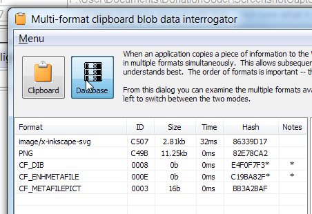

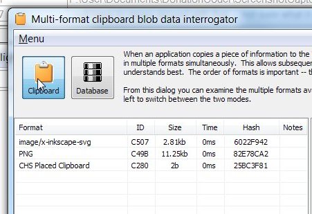

Mouser I cant find where to compare blob info -- you say under the view menu never mind it's under Tools menu. Can I actually compare two clips in this 'Interrogator' -- IIUC I can compare the clip that is selected in the main CHS window and the current clipboard clip. Here the difference between two of those duplicated clips shown above (they both paste correctly):
  1. One seems to have much less formats (?)
  2. Both appear to have a PNG -- this is not shown in the CHS 'Memo' pane
  3. EDIT// note the blob info of both of these clips is the same in the CHS memo pane -- apart from the milliseconds taken for each step

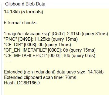

only difference I can see there is the milliseconds taken. There could be a difference in the png -- I havent looked for them (from Inkscape they are not shown in CHS).
Don't trust that view, it doesnt show HASH values -- I will add that now.
Ok I've uploaded a new version that shows blob format hashes now in main Blob tab; should make it easier to see if there are differences in clips.

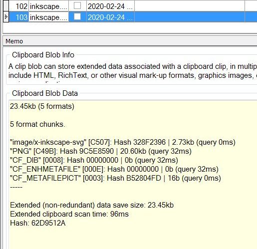

I found an issue that *might* be responsible for the double duplicate captures.  Can you download and try the new version and see if it still occurs even if you lower the delay to 200 or so.
:Thmbsup: with delay set to 200 only one clip gets copied.
I still get duplicates if I copy the same vector clip twice:
Code: (Generic)
39.12kb (5 formats)
5 format chunks.
"image/x-inkscape-svg" [C507]: Hash 41AFB00E | 2.88kb (query 31ms)
"PNG" [C49B]: Hash F408A94C | 36.13kb (query 31ms)
"CF_DIB" [0008]: Hash 00000000 | 0b (query 31ms)
"CF_ENHMETAFILE" [000E]: Hash 00000000 | 0b (query 31ms)
"CF_METAFILEPICT" [0003]: Hash 49E26D2A | 16b (query 0ms)
Extended (non-redundant) data save size: 39.12kb
Extended clipboard scan time: 124ms
Hash: 30403722
Code: (Generic)
39.12kb (5 formats)
5 format chunks.
"image/x-inkscape-svg" [C507]: Hash 89894DD6 | 2.88kb (query 31ms)
"CF_METAFILEPICT" [0003]: Hash 16F78EE7 | 16b (query 0ms)
Hash: CA51C702
Some hashes (lines 5 and 9) are different there, not sure what that means... or why they should be different, but I presume that's to do with the editor involved.

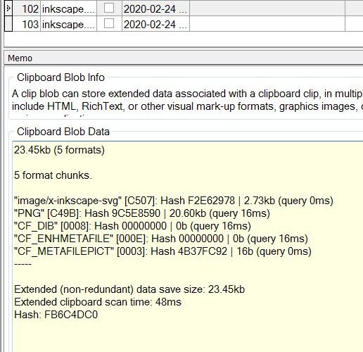

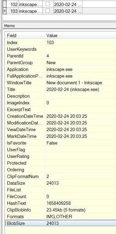

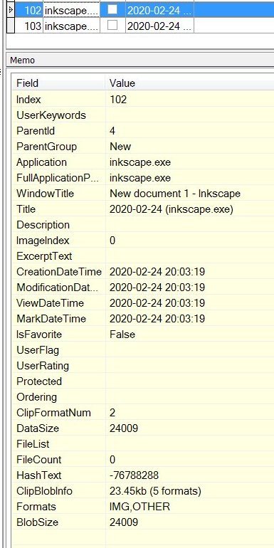

Sorry, not sure if that was directed to me, in case, here again two duplicate clips:
Screenshot - 2020-02-24 , 20_04_16.jpgScreenshot - 2020-02-24 , 20_04_07.jpg
Screenshot - 2020-02-24 , 20_04_24.jpgScreenshot - 2020-02-24 , 20_04_29.jpg

Since it says the hashes of the CF_METAFILEPICT are different and are only 16 bytes, I'm thinking that actually what happens is that for CF_METAFILEPICT, the data is NOT actually the 16 bytes, but rather that it's a handle to data, and so CHS needs to do some special processing to grab that metafilepict data to store and restore it properly.  I'll work on it.
