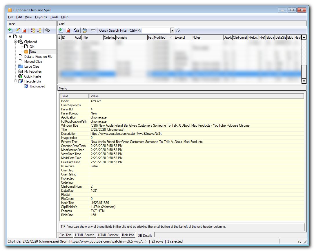

Current new tab available when you look at a clip:
Here you can see what extended format data has been saved alongside the clip.
The idea is that this information might help you later set some filters in the program regarding what formats you want the program to keep or discard.  Currently the program is not being smart about avoiding storing redundant formats, that's on my todo list.

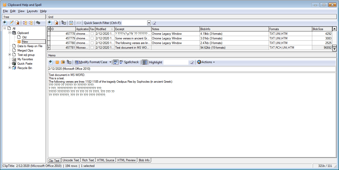

Re: Clipboard Help+Spell Extended Clipboard Format Data Discussion Thread
« Reply #10 on: February 03, 2020, 06:30 PM »

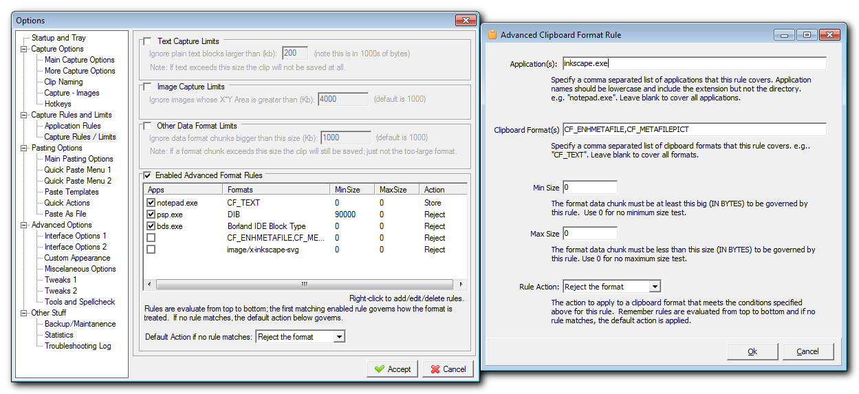

If you have ideas for options you would like to see let me know.
It's hard trying to think of options that would be suitable for non-experts and experts alike.

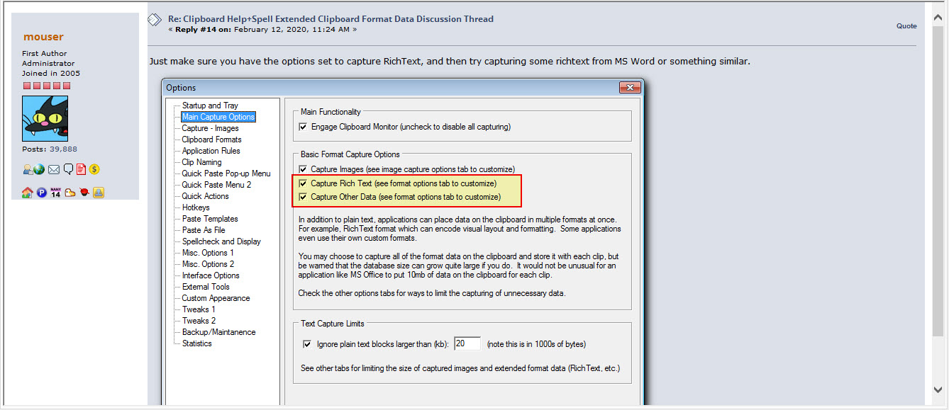

I just got this setup, and it seems to be working fine.  All I note so far is that it lacks a proper preview for graphical formats.  Is there something I need to do to enable the "Rich Text" tab I see in one of the screenshots you posted earlier, mouser?
« Reply #14 on: February 12, 2020, 05:24 PM »
Just make sure you have the options set to capture RichText, and then try capturing some richtext from MS Word or something similar.

Okay, those two checkboxes seem to be checked by default.  That would make sense.
When I copy something from the web, I do not get a same-format preview, and there's no Rich Text tab.
« Reply #16 on: February 12, 2020, 06:51 PM »
Yeah you can see in the BlobInfo tab that copying from a web browser does not get you RichText format, it gets you HTML format, which CHS won't preview..  I might be able to add an HTML preview tab though..
« Reply #17 on: February 13, 2020, 12:12 AM »
Try redownloading; new version has html preview and unicode preview.
Another surprise discovery is that the html block saved to the clipboard by browsers has the url of the page embedded in it.. This means I can more reliably grab the source url from modern browsers in the future.

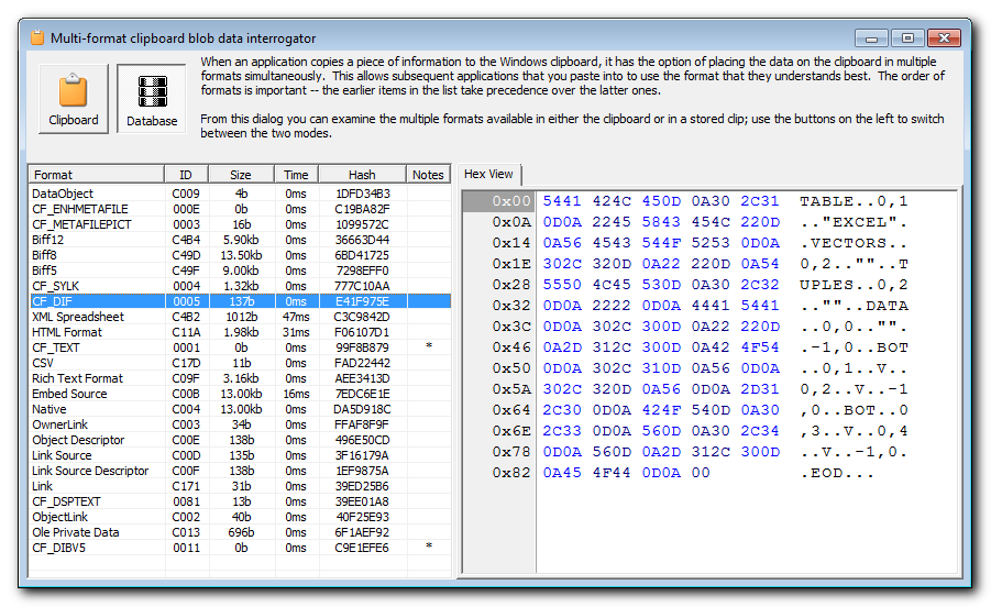

CHS doing multiformat:

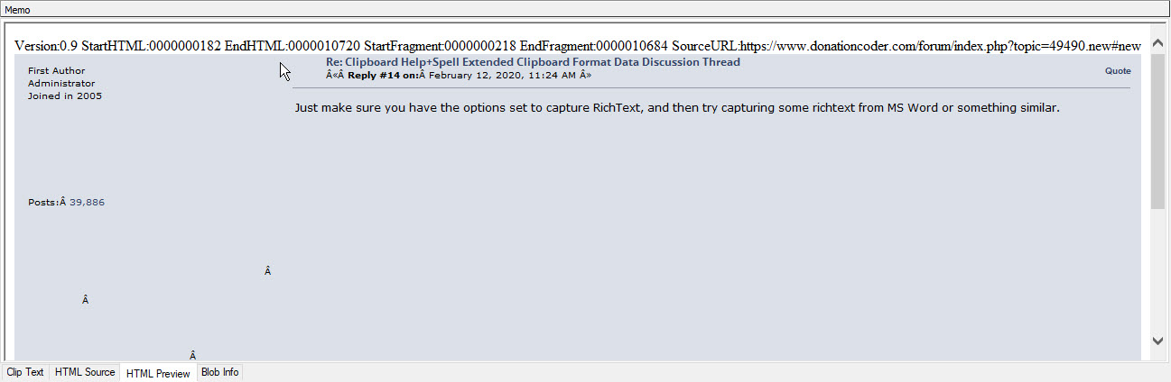

Just downloaded and unpacked the zip into my working CHSP folder.  This is what I see in the html preview tab of a capture I did from a few posts above this one.
« Reply #21 on: February 13, 2020, 05:16 PM »
That's normal -- I have the image downloading turned off.. If I turn it on it will look closer to the actual capture of the html, but it would be downloading the images to view them in the preview, which I'm not sure people want and not sure really what the point is.
