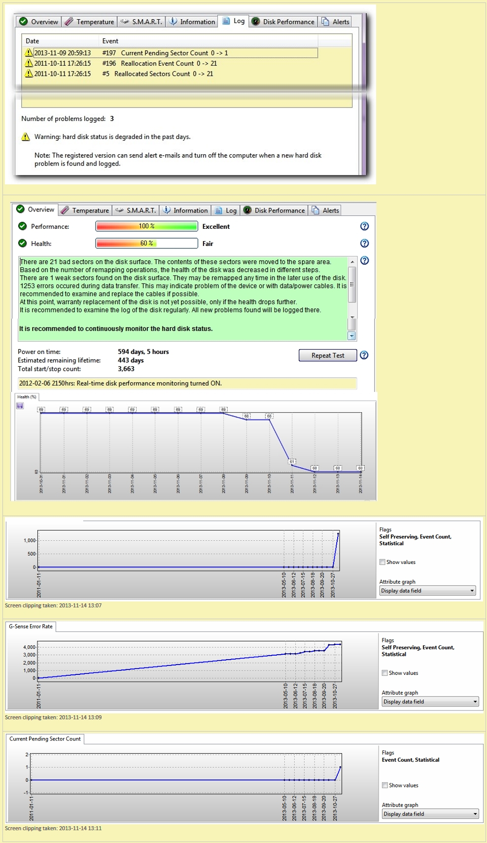

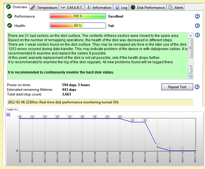

Was pouring over HDS reports whilst making a post in this discussion Re: How long do hard drives actually live for?
I had earlier noticed that the "Health" percentage had fallen from 69% to 60%, and went looking for the analysis.
Here is the overview as at 2012-02-03:
Here is the overview as at 2013-11-14:
Here is the latest problem analysis:
I distinctly recall at some stage banging the laptop accidentally against a door-jamb whilst moving it when it was still switched on. (Thus breaking one of my own rules about not carrying about an active laptop.) I also recall knocking it on my lap and nearly dropping it (whilst moving out of the baby's way.)
The analysis shows that a G-Sense event occurred around the date of the non-critical but unrepairable event #197 (Current pending sector count) appearing in the log. So, it looks like I did could have done this one myself. Sheesh.
« Last Edit: December 16, 2013, 12:13 AM by IainB »

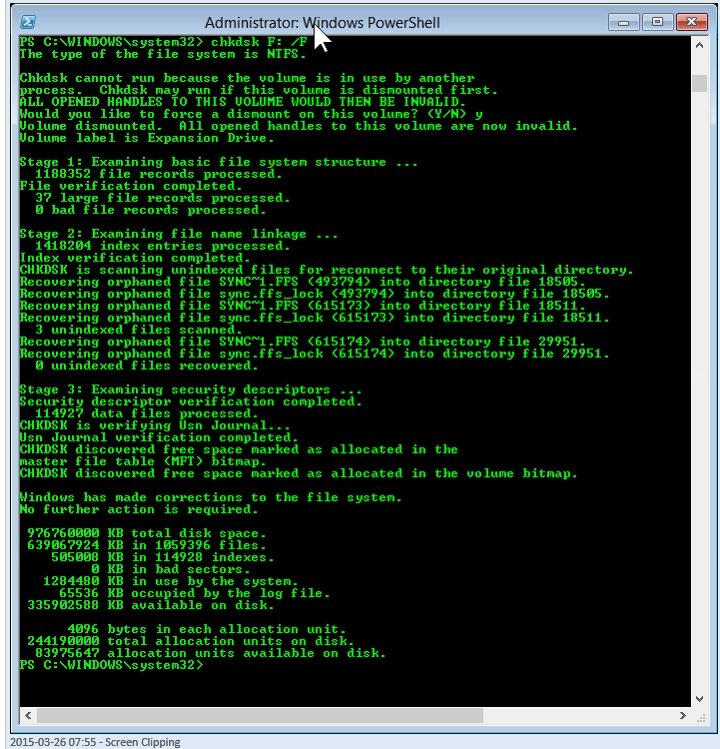

I'm puzzled by this: this is for a Seagate USB 2.0 external hard drive (1TB).
HDS says the disk is in perfect condition, but these SMART Raw Read and Seek Error Rates from HDS look confusing to me.
What is going on with this drive?

@4wd: Yes, I had come to the same conclusions as you seem to have done. There are some notes on the HDS site that indicate (in rather tortured English) more or less what the BackBlaze comment says (which I had not seen, so thanks for the link).
I think I may have deduced what those two SMART charts mean:
  • The SER (Seek Error Rate): the chart seems to be a graph over time showing when a Seek Error occurred and what the accumulated seek counter stood at, at that point.
  • The RRER (Raw Read Error Rate): the chart seems to be a graph over time showing when a Raw Read Error occurred and what the incremental read counter (reads since last error) stood at, at that point.
Explanation: Thus, we have, after an extended period of apparently improving stability/reliability (reducing frequency of errors), a second Seek/Raw Read error occurring on 2015-03-20 relatively soon after the last/preceding error, and then a third occurring relatively soon after the second.
We probably won't be able to establish what caused the errors, but I shall examine the Windows Events logs to see if anything shows there. However, we can see from the CHKDSK output (run after the SMART S/RR errors were charted) that CHKDSK:
  • corrected orphaned file errors, and found some unindexed files, in Stage 2.
  • corrected free space marked as allocated in the MFT, in Stage 3.
  • corrected free space marked as allocated in the volume bitmap, in Stage 3.
I don't know much about these things, but I would suppose that, if further S/RR errors occur within a short period, then there may be a problem causing reducing stability/reliability (i.e., increasing frequency of errors). Otherwise, the errors may be an improbable statistical coincidence, or the CHKDSK operation may have fixed something that could have been a causal problem of the errors, in (say) the file structure.
So, it's probably a case of "wait and see".
Yesterday I downloaded, installed and ran Seagate's proprietary SeaTools software to check this (Seagate) disk, and it checked out with no problems on an "extended test" run - and Seagate's own instructions are that if it passes that test then there is unlikely to be anything wrong with the disk.
I wouldn't have known about any of this at all if I had not had the HDS information charts showing the disk health status and the SE/RRE counters' data from that particular disk.
