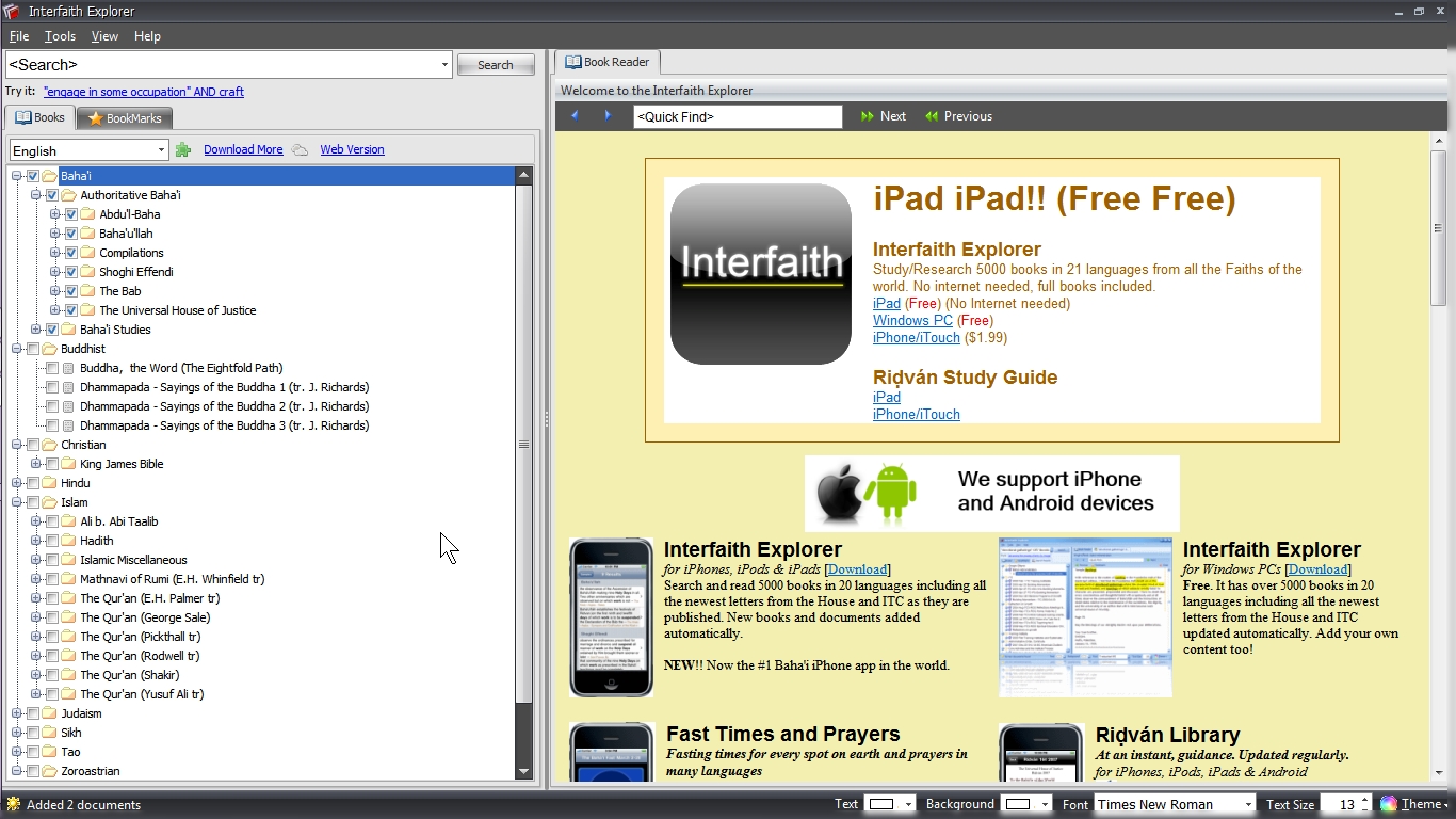

App NameInterfaith Explorer
DescriptionReligious text repository and referencing system, available in 20 languages.
Thumbs-Up Rating :Thmbsup: :Thmbsup: :Thmbsup: :Thmbsup: :Thmbsup:
App URLOnline version: http://bahairesearch.com
Download the client: Interfaith Explorer
App Version ReviewedSeveral versions, up to and including v2.4.0 (current since 2013-12-30)

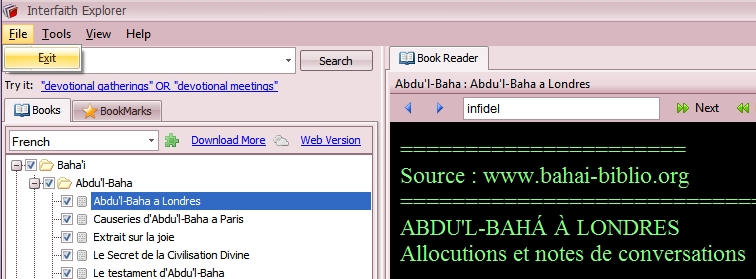

- trialled by me in English and also with the French plugin. There are 20 language plugins in total.
Test System SpecsMS Win7-64 Home Premium
Supported OSesPC Windows (various) andiPhones, iPods & iPads
Support MethodsRegular updates and access to feedback to/from the application developers.
Upgrade PolicyAutomatic updates.
Trial Version Available?Not applicable (This is FREEware.)
Pricing SchemeNot applicable (This is FREEware.)

Rather than write an introduction out from scratch, here is the post from the Basement thread God's Server that I had made in response to someone else's earlier comment. This should suffice as an introduction, as long as you appreciate that context:
It is said that God is infinite, omniscient and omnipresent - and for all we know that could be true - so by definition he probably can't be "too busy". That is, there would arguably be no queuing involved.
However, that doesn't mean that you can't use computer network servers to spread the word. Previously largely a purely manual process and the domain of "holy men" (rabbis, vicars, priests, imams or their acolytes) spreading the word involved preaching to assembled congregations and reading out passages of various bibles and sacred texts for students/worshippers to recite and learn by rote.
Recite no more. Automation of the manual process and some subsequent enlightenment can now be easily distributed across the network, relatively painlessly. The best example of this that I have come across is via the Bahai faith's website - http://bahairesearch.com
There they have the online Interfaith Explorer, and you can read and cross reference the main books from the main religions.
You want it offline too? No problem. From this superbly informative website, you can download the local client application (for various languages) Interfaith Explorer
Once you have that you can read and cross reference the main books from the main religions on your laptop/PC.
Prepare to be somewhat amazed. Well worth at least an exploratory read.

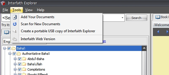

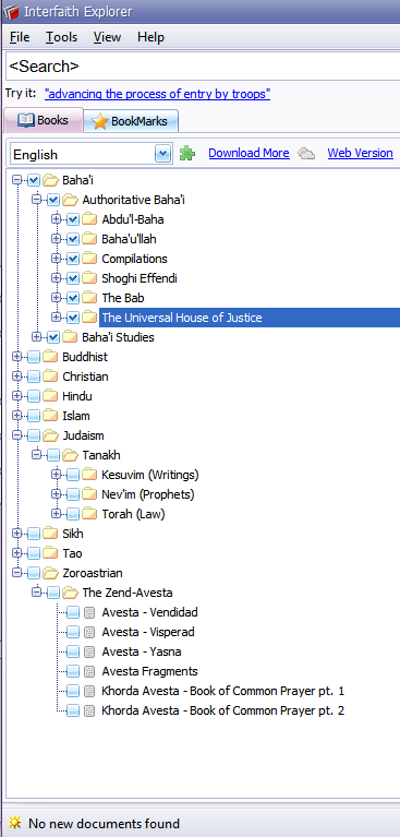

It's heavy on Baha'i texts, but it looks like you can manually add more relatively easily as the files are all nice, simply flat text files. (Looks like you could add in just about any text file and extend it to something entirely new, like a philosophy and religion comparative reader, etc.) I've not tried that yet, and haven't read the docs - just played with it a bit so far. But it looks pretty damn slick for what it does.
It doesn't look like a replacement for something like SwordSearcher, but gives a higher level overview across faiths.
The lack of notes in there is a bit of a drawback, but not really a big one.
It also stems words, which is really nice. e.g. You can search for "<X>ment" and it will turn up "<X>", etc.

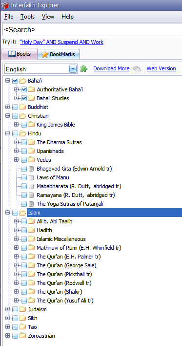

@Renegade: You could reasonably expect that it would include all the Baha'i texts, since it is a Baha'i-created repository, after all, but actually it seems pretty comprehensive over the other faiths' texts too - though that is only what I observed from the English translations, so I am unsure whether it might be true for translations in other languages.
For example, having six (6) English translations of the Koran ("Qur'an") is quite impressive, but the French version ("Le Coran") looks pretty limited in that regard, by comparison.

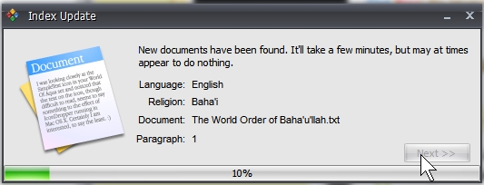

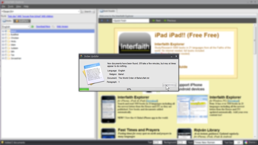

Okay, my project machine is up and I have full strength internet, so les'see this thing again...
Ongoing notes:
1. Save your experience to only trying this program out with a good internet connection. Some of the downloads are rather large and/or it needs processing power. For example it's maxxing out my CPU doing the index updating on my at least medium grade project machine, which clarifies why my old laptop didn't stand a chance.
2. Between the cpu and a memory spike over 400 megs, I did crash once so far. (My XP box, 2 Gigs ram.) I tried setting the process "below normal" to see if that helps.
3. Slightly Very unintuitive status info! For example you can think you have completed your update only to find not so much is there. So then when I clicked around and went to "scan for new" it seems to have found more documents. As of this note I am trying to find the Buddhist update, and it's not quite easy. I keep trying to click "Buddhist" and add documents and I keep getting more Bahai ones. So it might only have an example shell of the other faiths!
... Continually doing "scan for documents" seems completely unclear! It seems to be doing some mix of adding only a few docs at a time in sweeps, and repeating some. The names click by pretty fast. I'll try a few sweeps.
4. I found a bug! I "Hard-Closed" the program during a scan and it lost its database! I am re-scanning it back!
« Last Edit: September 29, 2013, 06:52 PM by TaoPhoenix »

Final Opinion:
A really good start as far as it went!
But it does seem to lack some important things around the edge!
1. Really weak Buddhist section! There's really nothing there.
2. The power is that it runs off source documents. But that is also its downfall! Once you have the basic materials, I am finding I don't need the explorer! Instead, just use more typical text processors of your choice (see the various threads) and then you can do anything else you normally would to a text file!
And so I leave it!

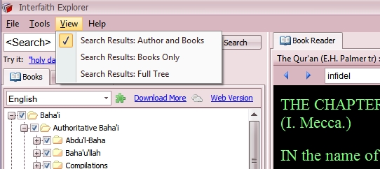

Kind of, but not really. Check this:
You search for "murdered" but get "murderer" returned. Stemming is a great tool that you won't get in a text editor unless you are searching through files using regular expressions and know how to properly stem words yourself. It's quite a bit more effort to go through. It was one of the first things I noticed in there as it's such a great feature to have.

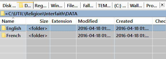

I also download the spanish plugin. And installed.
But the english plugin is a folder ?
How can I install ?
Re: Interfaith Explorer (FREE) - Mini-Review
« Reply #17 on: August 18, 2017, 06:47 PM »
The folder should be placed in the DATA directory (wherever you installed Interfaith).
e.g.,  C:\UTIL\Religion\Interfaith\DATA
Contro
  • Posts: 3,947
« Reply #18 on: August 26, 2017, 08:42 PM »
[attachment 1 not found]
Understool. All running
Best Regards
