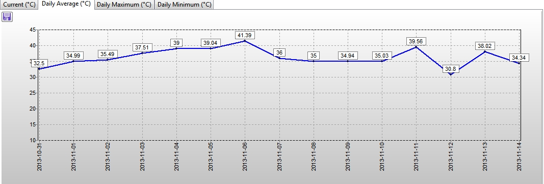

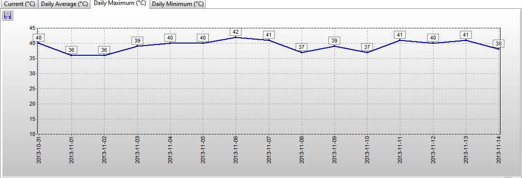

This rather makes sense, and in the case of the 7200rpm 500Gb 2½" hard drive in my HP ENVY 14 laptop, it corresponds with snapshots of the daily temps, as below. These are reports from Hard Disk Sentinel PRO:
Daily average temps.:
Daily max temps.:
