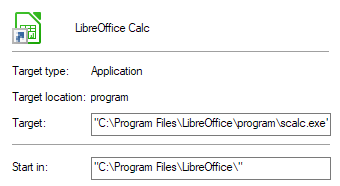

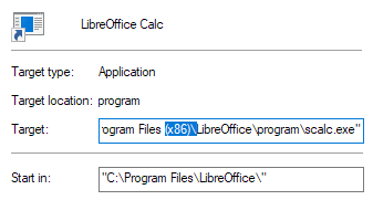

As previously mentioned here and some other topics, FARR somehow incorrectly loads icons for 64bit programs.
A perfectly working shortcut's properties as shown by the system:
The exact same shortcut file, shown by farr:
Is there a solution (or acceptable workaround like some hack in farr) to this issue in sight, please? It has confused (only just found it was farr all along) and annoyed me for years by now. I read that it was actually fixed before but then regressed.

I was going to post and say I didn't know why that might be happening, but I see the icons are problematic for shortcut links to 64bit apps.. I should be able to fix..
I'm going to do a FARR update this week so I'll try to get it done this week.. Would appreciate any help testing.

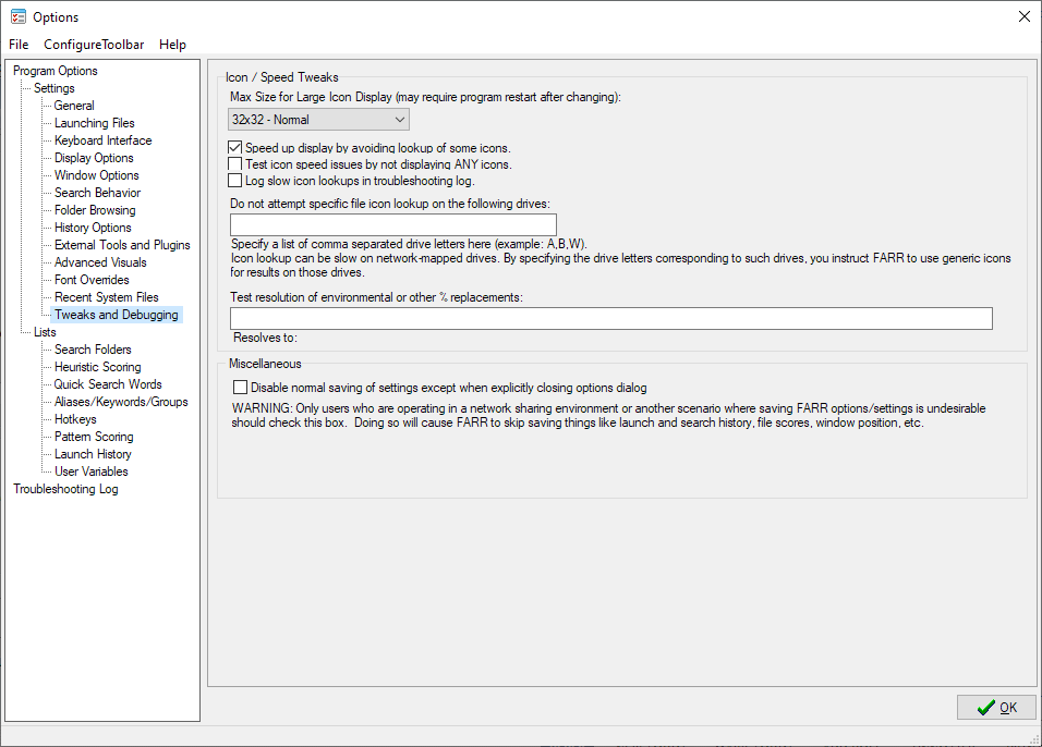

Faziri, I don't think this will matter but can you show me the "Tweaks and Debugging" tab of your FARR preferences:
Faziri
  • Joined in 2013
  • Posts: 10
Re: Broken icons for 64bit programs
« Reply #4 on: December 26, 2019, 07:54 PM »
Turning that option off and restarting farr doesn't change anything
« Reply #5 on: December 26, 2019, 08:10 PM »
Ok just checking..

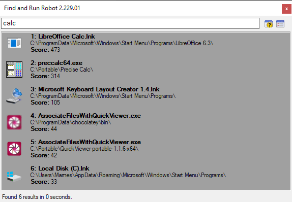

Here's the weird thing.. Here's my search for libre, on win 7 64bit, with libreoffice 64bit installed:
« Reply #7 on: December 26, 2019, 08:39 PM »
So the question is.. why is it showing fine for me but not for you..

It's possible that even though it's displaying properly on my machine, it's actually asking Windows for the wrong icon file, and that I can fix it.  I just want to eliminate other possibilities first..
What OS are you using?

Well I'm om 10, so probably some influence from the OS changed between 7 and 10. Would you like to set up the source code and dev env on my pc and remote into it so you can debug it?
No, though I may have you try a debug-build that will log for me what files it thinks its asking for icons from.
Hopefully it's simply a matter of FARR mistakenly asking for the icon for exe that it thinks is in Program Files x86, when it should be specifying the file in Program Files\

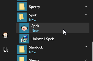

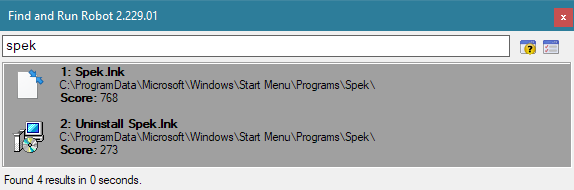

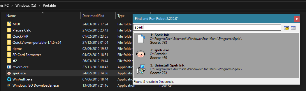

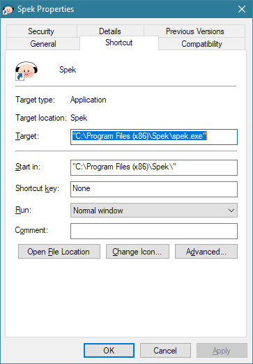

I just noticed another broken icon, but it seems to be a diffferent problem. This happens with both the latest release and this thread's beta.
The properties window is the one opened through farr, which for the previous issue showed the broken path. This time farr actually gets the path right. The "skip some icon lookups" option is disabled. This copy of Spek (0.8.2) is installed with Chocolatey (which shouldn't make any difference).
Also, the latest release from the homepage installs 2.229.01 while the website says it'll be 2.234.01. The beta installer installs the same version number, 2.229.01.
Copying the exe to another path makes the icon work:
« Last Edit: December 28, 2019, 03:13 PM by Faziri »

« Reply #21 on: December 29, 2019, 09:11 PM »
>  it might help mouser if you explicitly say
We were in touch via email, no worries.
And yeah, only for spek.lnk. Attached the exe and shortcut (spek.alias = spek.lnk). This seems to be a different problem from the original, but it also only happens in farr, so...
Faziri
  • Joined in 2013
  • Posts: 10
« Reply #22 on: January 03, 2020, 11:48 PM »
So I figured out the problem; there's nothing wrong in farr, but the program installer. The icon path for this shortcut was set to `%SystemRoot%\Installer\{7CDF6754-F5A0-4F34-B589-197530FEF862}\ProgramIcon` — instead of the relevant exe/ico/dll path — which is actually the icon as shown. So false alarm, sorry. Very strange installer behavior.
