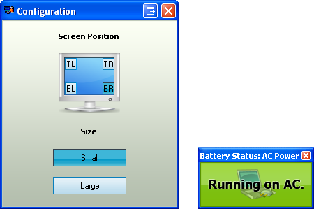

scancode wrote this some time back - BatteryStatus.
• http://www.donationcoder.com/forum/index.php?topic=20301.msg181616#msg181616
